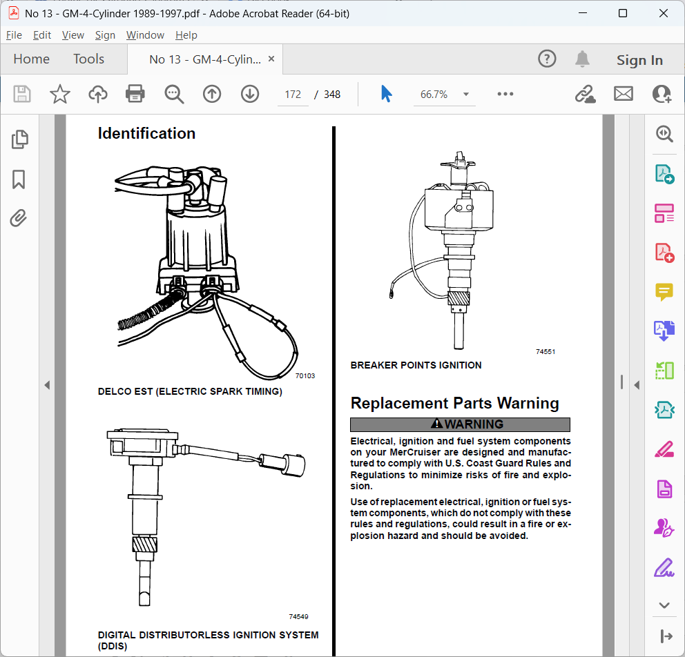

This is what the distributors look like
Try this, There is a shift interrupter switch on the shift plate, it has 2 wires on it.
