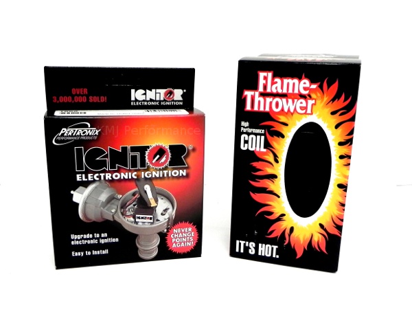

Ok so I have purchased the electric ignition and flame-thrower coil. I am going to install it but can someone help me and make sure i am going to do it right.
Electric Ignition - black and white wire goes to negative terminal on coil. black wire goes to the wire i removed from the coil negative side.
Flamethrower Ignition Coil - positive terminal has a wire running from it to a ground. negative terminal has the wire going to the black and white on the electric ignition on the distributor
Am i missing anything? Or should this pretty much get it going?

Instructions say to run the + to either a 12v battery or chassis. The Flamethrower coil has a internal resistor so I would not be hooking it up to any ballast
Ignitor and Flame Thrower Coil Kit for Delco 4 Cylinder Clockwise Rotation Distributor w/ Positive Ground
So did I purchase the wrong type of ignition?? It looks like I may have. This is for positive ground.. A little help here..... A positive ground system means that the positive terminal on the battery is run to the chasis somewhere???
Yes it means just that, ground is off the positive terminal and the chassis is ground as the positive terminal connects to it. Negative terminal goes to the devices, lights, switches etc. Older vehicle and tractors used this system, in the early < 1955 vehicles, until it was discovered that electricity did not flow the way the scientist said it did. :confused:.

WRONG parts.
You need the negative ground system and you also need a NON resistor coil. The fact is you can use your coil and only need the electronic parts that go into the distributor.
Your engine wire harness already has a resistor wire biult in. (~ 2 ohms) If you add a internal resistor coil you will double the resistance and that will not be very good for your ignition/spark.
When you see a vacuum diaphram advance unit, you can just about assume that this is an Automotive kit.
To my knowledge, the auto industry hasn't used a reverse polarity battery system for years.
Negative is commonly the chasis connection.
