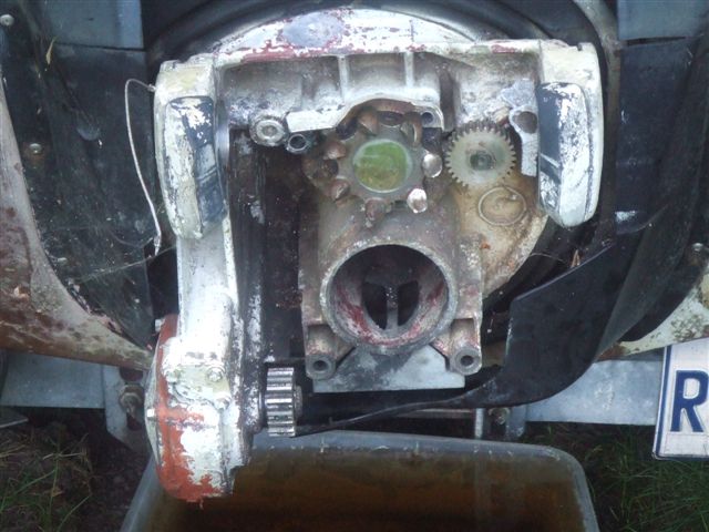

I bought this boat a 77 Larson day cruiser. The out drive is missing he said it snapped off in a parking lot. So I have know idea what out drive to get and they all want to know if its electric shift. How do I find this out.
It has a 8 cyl omc Ford 302 I think. Please help me this is driving me crazy.

Ok if the drive snapped off you got more problems then just buying a drive there has to be damage to the intermediate.
I or we will need to see pics, take one full on of whats on the back now and a couple of close ups.
The good news i know this drive setup and others here know your setup real good .
The bad news depending on how bad the damage is, it's gonna cost some real money to get you on the water.

You need a intermediate. So now you have a choice. You have tru course steering.
If you can find a boat with a bad motor and a good intermediate, and mechanical shift 82-85 drive buy it.
tansfer over the intemediate shift throttle and cables and drive and your good to go .
Or pull the motor out ofyour boat and strip this boat and sink the hull, sell what you can and go buy a different boat.

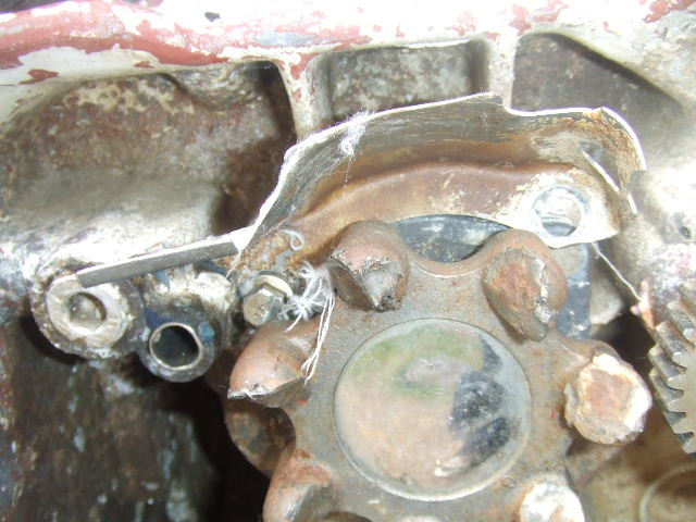

The trunion caps there, i think i see them broke off. Ears also. Maybe i can't see too good, maybe he can pry off the rubber bumpers and send a pic of that, ball gear for sure shot.
I can't make the choice for him this barge ain't worth 100 bucks, maybe if the motor is good do we know that?

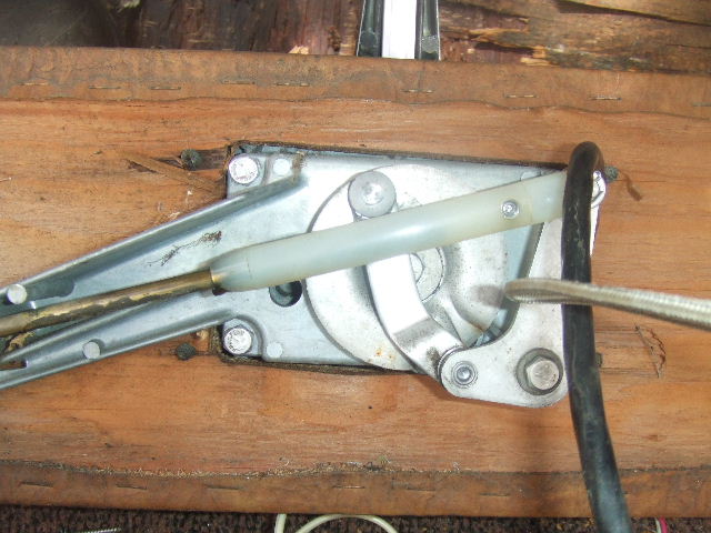

The motor is mint. Runs like a top.I stuck a wire up through where the shift cable is I found that there is 2 wires cut off so I guess It is electric shift.I bought the boat for $800 came with a tandem Axel trailer and I just found a out drive for $300 . If it is electric shift. running I have It sold for $4500 God I love this country.

From the look of the damaged area, me thinks the leg snapped off whilst "Cruising" the waterways.
That damaged Ball Gear could have physically pushed it off.
