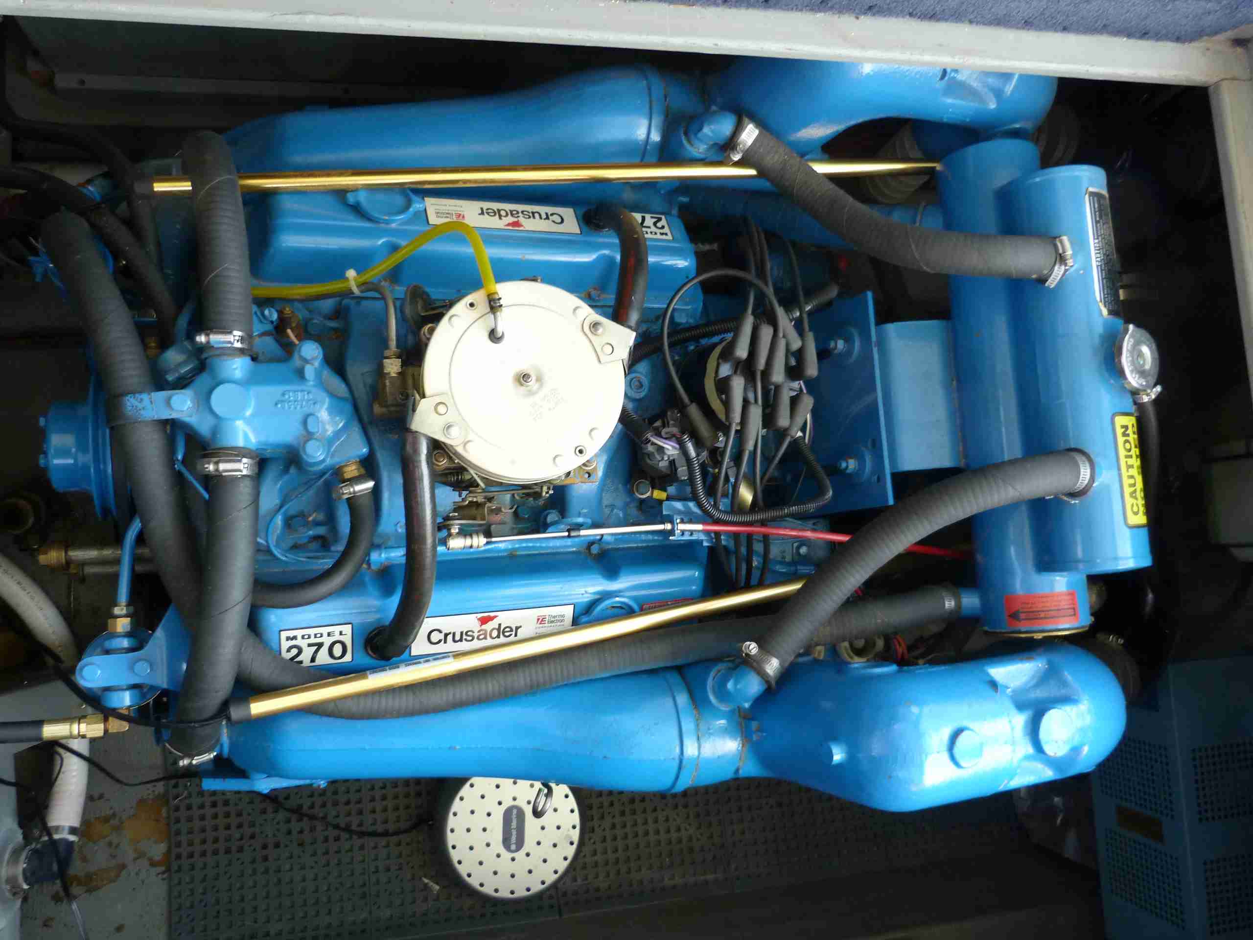

I have twin 270 Crusaders (350 block) circa 1983. Have aprox 500 hrs and 9 years on the risers and elbows (Barr Brand) used in PNW salt water, Rinsed and RV antifreeze every Winter.

Yes, corrosion is what I meant by "wear" and they are coolant cooled on the outside I believe. Its a typical Crusader full system from the 80's
Indeed...and looking great.
