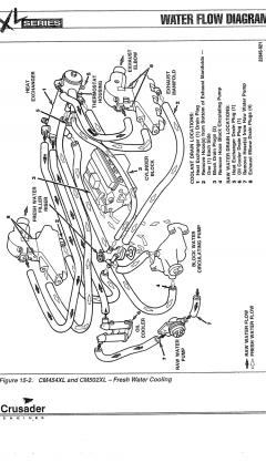

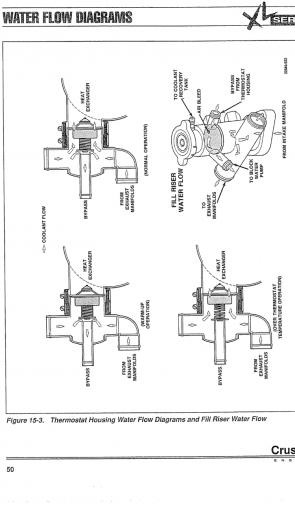

there are three types: raw water cooled, and two FWC versions - the difference is where or not the exhaust manifolds are included in the coolant loop (then its a FULL FWC setup) or in the raw water side (then its a half FWC setup) and the latter are pretty rare nowadays. The elbows are always cooled with raw water. The other variation is that on applications with risers, they can be on either the raw or closed side. most OEMs put them on the raw side....

you mean between the full and the half FWC'd systems? Look in the owners manual or the engines.....and see how the exhaust manifolds are plumbed in. I usually look at the thermostat outlet hoses; if they go to the bottom on the exhaust manifolds, they are 'full' FWC systems (most typically used in the past 20+ years).
Hi, these two diagrams are in my manual. From looking at the FWC page, does it look like i'm 'full' FWC? Not sure how much it matters, but be nice to know.
