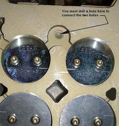

I received the new carb yesterday and I have a quick question. It came with holes already drilled (actually, cast) on both ends (see photos). The holes are "blind" in that they don't open up to anything in the back. It looks like they are already ready to be tapped, although they appear to be 23/64" (I don't have a 23/64" bit, but 11/32 bit is loose in the hole and 3/8 does not go in). I'm not sure if that is too big for 1/8 NPT.
Did your carb come with the holes already in it? Can I still tap for 1/8 NPT or do I need to find a different solution?

Maybe my Performer 1410s sitting on my 454s are manufactured differently, but there is only one hose barb which is for the manual fuel pump overflow and is located between the choke and the fuel inlet. There no other hoses. The two hoses from the valve covers (that would be for a PCV) run to the flame arrester.
Edelbrock's installation instructions do show a "PVC port for 3/8" hose on the front of the carb body between the idle mixture screws as Jeff shows. He's the expert and is more familiary with MOPARs.
