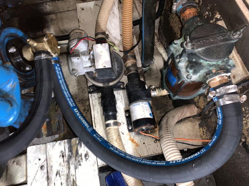

This is the Sherwood E35 belt driven raw water pump we are removing and replacing with a Johnson F6B-9, Model #: 10-24930-01 crank driven raw water pump. The engines are 1986 Crusader 7.4L CH 350, 330 HP. Both are mid 8000s serial numbers. Ignore the oil! I will be fixing that hose next.

Judging from how you have plumbed the suction and supply hoses, I assume that this is a REV RH Rotation engine!
attachment.php
If this is a Std LH Rotation engine, your suction and supply hoses are reversed.
