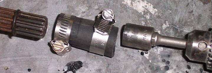

Drop the LU and see if the impeller looks okay. If so, bucket test it with a 3/8 drill. If okay, force water up the tube to the power head with a hose. If all of the above are working, reassemble--being careful to get the water tube into the LU correctly--and it should pump fine.
Jeff
PS: The photo shows how to hook thne driveshaft to your drill.
Jeff
