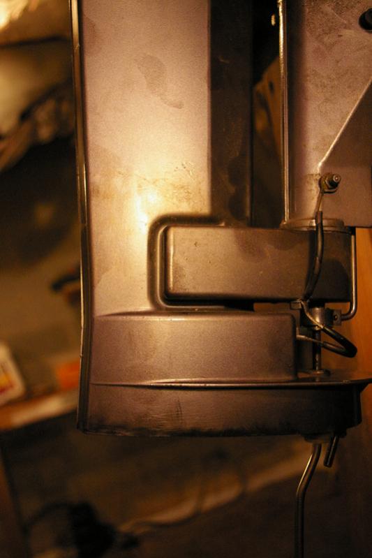

Year is unimportant for servicing a Nissan outboard. Sorry, I missed the serial... which is indeed for a 9.8B. S is for Short, L is for Long. In order to change the ds housing, you will need to pull the power head. Grab a Factory service manual (available from any dealer, including me), and review it. You will be in for a few hours of turning wrenches. Is the drive shaft true, with no twisting? If the prop struck the bottom, the hub is likely spun. That could be your speed and vibration issue. Do you have a picture or 2?
just took some for you, can you see the bend on the housing? motorshafthousing.jpg
Wow. And the rubber mounts didn't shear? Amazing. Yes, it does look like the casting is bent along the back... also amazing it didn't tear on the forward edge. Running at speed with the drive shaft that far out of true would tend to make it whip, which sure could cause a nasty vibration.
