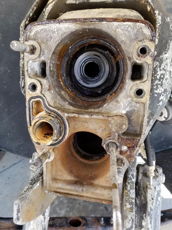

I believe its a dp-s.. I looked ata diagram to verify, no ring to seal rear ujoint section.. and no drive gasket?! How on earth does this thing seal? Pulled drive today, def signs of water in ujoint area.. I cant figure out how the unit seals.. only the bellows showing and drive, with the 4 grooves for the bolts theres no way it will keep the water out.. plus no gasket either?
Just seems unbelievable...
Close up: some of the alu is corroded away but still seems to have a very good seal from clamp:
Here are pics:
These openings in the casing is prime for water to come in: Arrows point to bolt channels - how would that offer any sealing? Also - on upper cover theres a good 3/16 gap -
Hate to say it but im tempted to make a darn gasket and put in a ring in the bellows facing aft... and rtv the upper section where theres a HUGE opening into bellows area..
