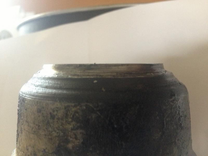

Last season I had a prop slip on the hub. This caused the prop to rub against the bearing carrier. I did do some damage, I am just not sure how much, as I can't recall how it looked before.
In looking over the carrier and looking at the shop manual, something doesn;t seem right. It says the seals are inserted from the AFT side, but a seem to have a lip from that side. Can anyone confrim what side I should be installing new seals from? Is it possible to do the new seals without the speacial tool for installing them?
You've lost a good portion of the housing.... and most all of where the two seals install.
The AFT-most end should look like this one.

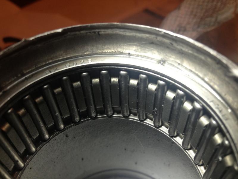

I took the dimmentions of the exisitng bearing race. Are these the dimmentions that you said need to be folowed to avoid shimming? Dim "D" is approximent, because I had to take it with feeler guages, my calipers are to big to get in there.
What is the best way to pull the exisitng race out? (Without the factory tool that is). The lip doesn;t seem large enough to use a puller. Or will a couple rounded 1/8" flat stock work, putting the in the senter then shifting them outward, then press them out?

Volvo Penta did shim behind the bearing race in the beginning. There were some issues with the shims shifting and becoming damaged.
With the later drives..... the shimming was relocated to forward of the roller cage.
To change the bearing carrier, technically the shimming process should be performed again.

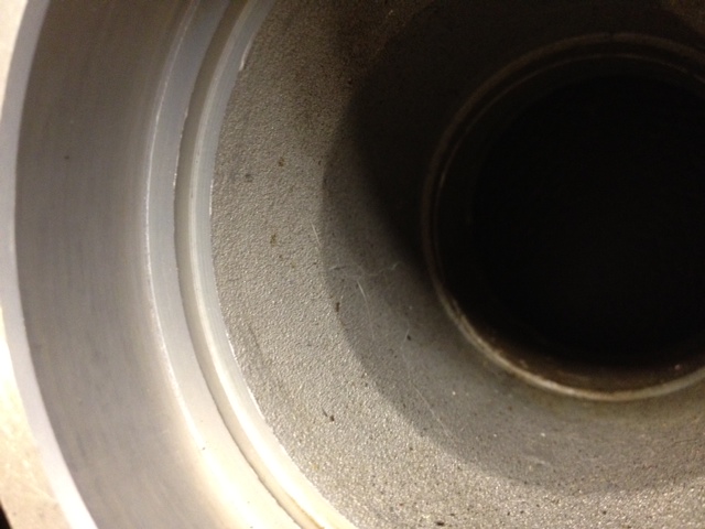

The bearing race will come up against a stop within the carrier.
Why you are not seeing the stop shoulder, I don't understand.

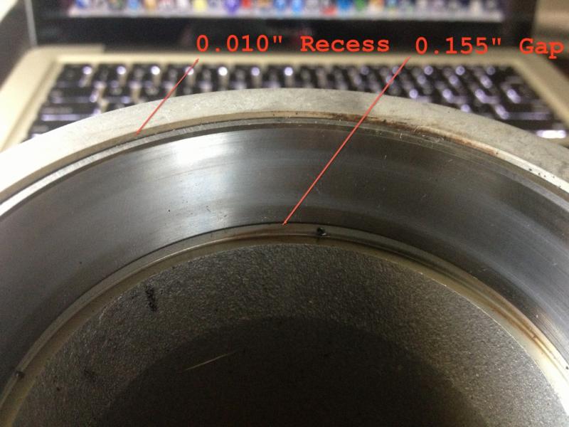

That is why I questioned the lack of shim inside the carrier. The race is sitting down 0.155" from the stepped surface.

Timm, that shoulder is not the stop for the bearing race. It's simply a relief cut during the machining.
A race that was positioned 0.155" forward of the stop surface, simply would not work.
The apposing forces against the bearing race would drive it further into the carrier.
Here's a bearing carrier with the race removed.
This shows the relief cut, and the race stop shoulder.

The one thing I was thinking of is the existing carrier is so chewed up, I can't use the aft face down on the table. I was thinking of drilling a hole thru the table and bringing the indicator from below. Then setting the carriers fwd face down. Out layup table is milled at 2" thick, so in hoping the indicators I have will have enough stationary shaft to reach thru. If not I might try to chuck it in the lathe and clean up the aft face.
thanks got all the advice. I will definitely take spme photos of what I do and post them here.
Simple..... Chuck the carrier up in a lathe, turn it slowly and true it, then reface the AFT end!
It doesn't matter how much of the AFT end is removed, as long as it's perpendicular to the bore, it won't affect your dimension.
