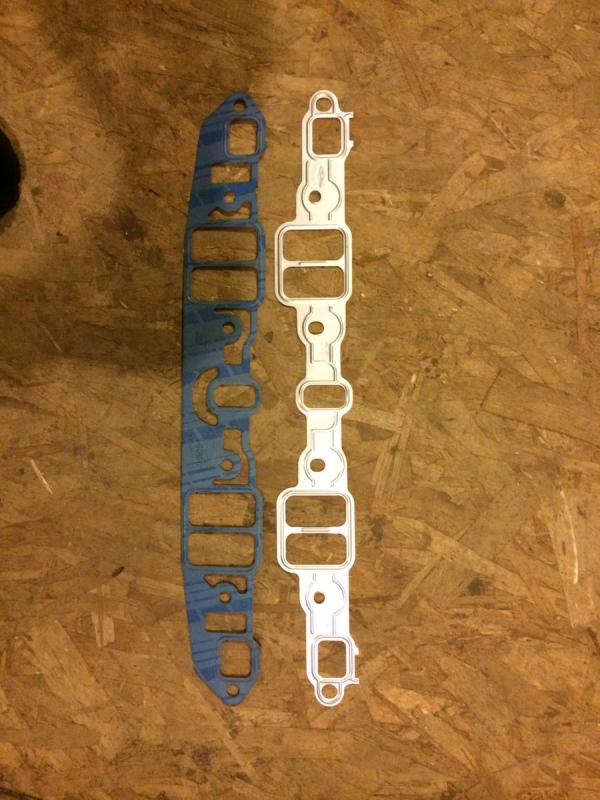

Turns out the other head was cracked so bought 2 re manufactured heads @ 150/ea from cylinder heads international - there on their way to me now. Question (see photo) - I got two air inlet gaskets per side - I metal the other gasket type material. Do i use both? Metal against the head? Or is the metal gasket if it is raw water cooled? (Mine is fresh water cooled)
Either will do--I'd use the non-metal ones--but don't forget those little metal plates that reinforce the gasket at the exhaust cross over passage.

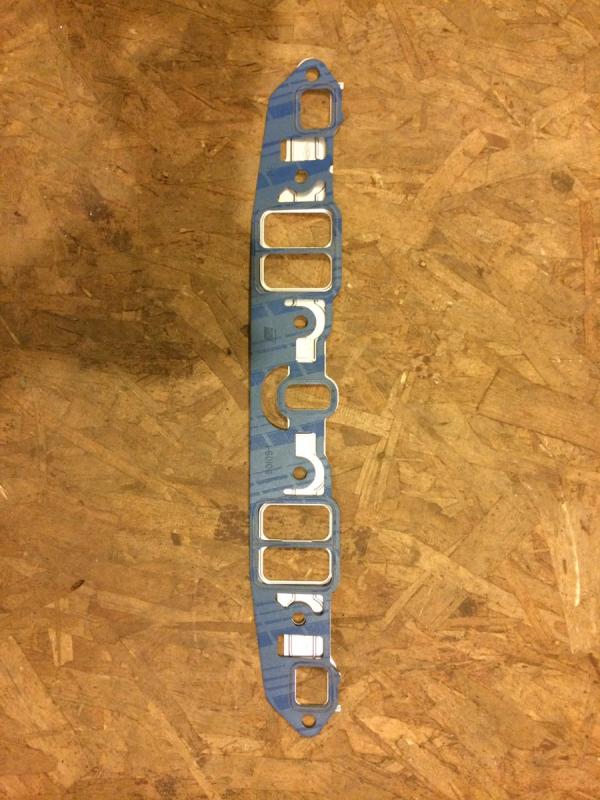

Jeff - where do I get those? They didn't come in the gasket kit? From another post it looks like I need Fel pro 17350. There are 4 metal inserts in that package. From your picture it looks like metal goes on both sides of each gasket - i.e. metal insert on each side of the big gasket?
What type of gaskets were on the engine at tear down? Were these restrictor plates on the gaskets you pulled out? They may be standard for marine application intake gasket sets if you search that Fel-pro number .
Looks to me two per gasket, one on each face of the gasket. Fold the tabs over to hold the two together. These are basically a heat crossover restriction and provide blowout support for the gasket. You might be able to make your own from some stainless sheet stock. Use the gasket as a template.

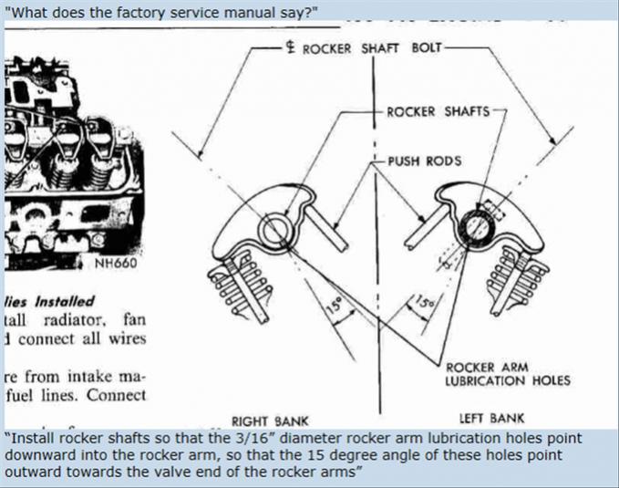

Rocker Arm Shafts
When installing the rocker arms on a shaft type system of a Chrysler engine, the shafts must be installed correctly. There is a difference in the top and the bottom, as well as side to side. The shafts must be installed with the oil holes pointed to the bottom and to the outside of the engine, toward the valve. This is the only way the shafts can adequately oil the rocker arms. Premature wear will result if the shafts are installed improperly.
There should be a notch on one end of the shafts. The notch on the odd bank shaft should be rotated down and over #1 cylinder. On the even bank the notch on shaft should be rotated down and over #8 cylinder.
This orientation should have the oil holes toward the valve side and not the pushrod side.

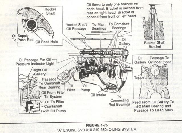

If you have "good" oil pressure (approx. 40 psi hot) the lifters are getting plenty of oil.

plugged oiling hole in shaft

Thanks Jeff & Dave 69. Started it up this morning - only a slight tick. Ran it for 20 minutes. Listen to attached video. To answer Dave's questions: Oil pressure over 40. Rocker shafts were torqued to what was in the manual (not here - on boat). Used a stethoscope on each cylinder - they all sound the same. I made sure all the rods were lined up properly while torquing and after. I used a auto cylinder head to exhaust manifold gasket on that side - there may be a small exhaust leak. With the stethoscope on the manifold and each cylinder - all have the same sound signature. Oil is slightly over full but clean after approx 2 hrs runtime. Thanks much for the diagrams!!

The rocker train assembly, when assembled and oriented correctly, will work on either bank.
In the links picture note the "notch" down and forward over #1 cylinder. Also note the rocker arm positioning for left and right.
