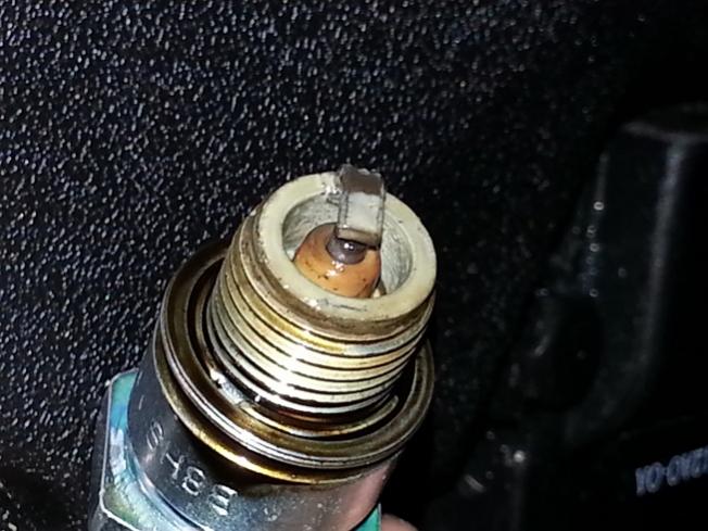

Onto the second point... I think the SLOW was acting correctly on the engine overheat condition (because of the broken thermostat). Now, the thinks started to get darker because I remembered that when I checked the spark plugs after my test ride on the lake, they were coated with milky substance (wet, not powder like -- lean). U-huh, water in the cylinders!!!! So late night ~1am I couldn't fall asleep and had to check the head.... Yeah, I had to go down to my garage and bite the bullet...

Here's the picture of the milky spark plug.
