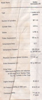

The engine is sitting on an angle, so the valve cover hole on Port side it sitting 3" higher than the starboard valve cover hole.
I do get some blow by due to the engine being a 1965 426B (points). I sometimes get oil from the oil stic tube of the port engine, which has the PCV valve on the SB valve cover (lower than the breather). DO you think swapping whicj valve cover the breather vs the PCV valve connects makes a difference?
