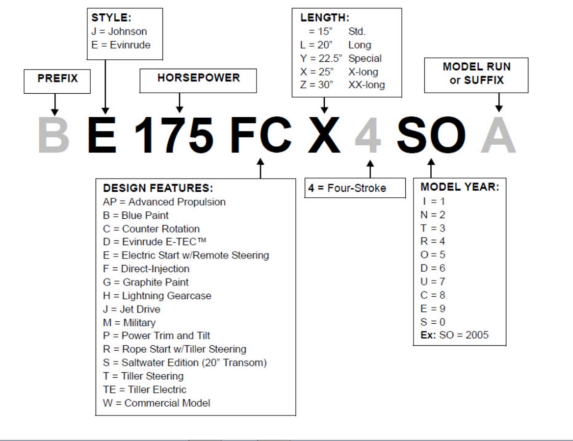

E10RELEIR
Evinrude 10horse power, rope start,long shaft,electric start w/ remote steering,1991
I think I’m incorrect bc how can it be both tiller an remote steer? I believe this is a remote steer. maybe my code chart is not for this year model. thanks for advising

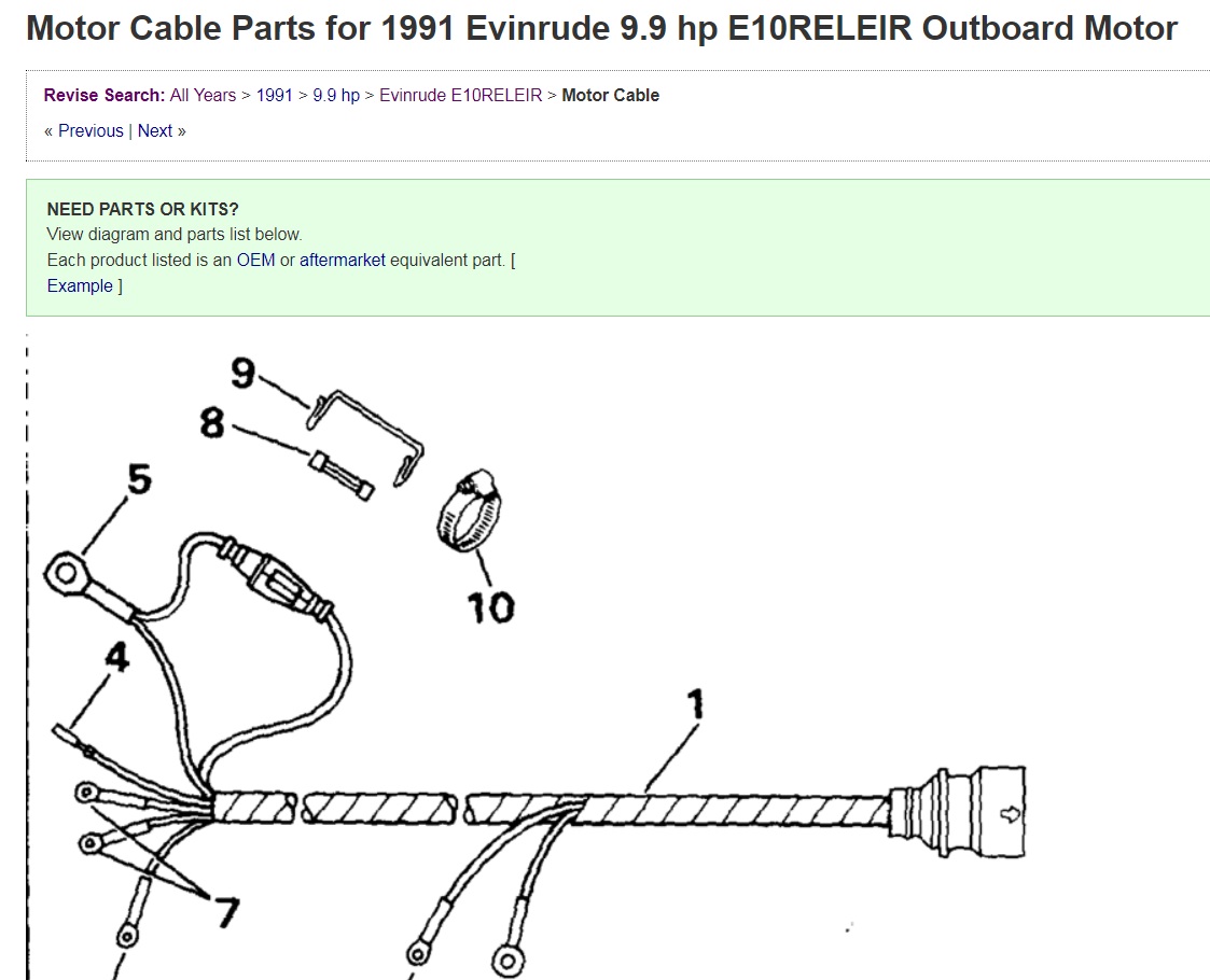

not sure if the main wire harness is included haven't heard back from seller.
is this the main wire harness? I assume any BRP binical will plug in?

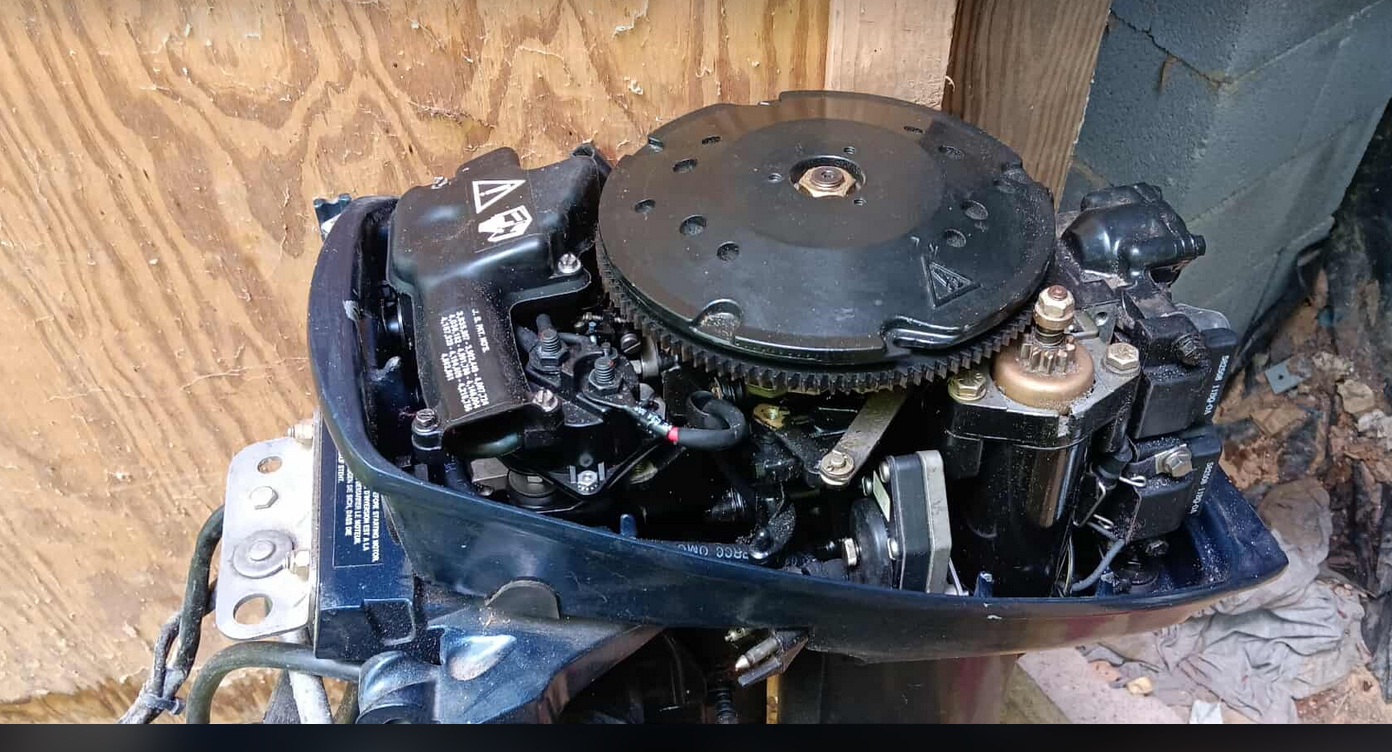

I now see there is an electric starter

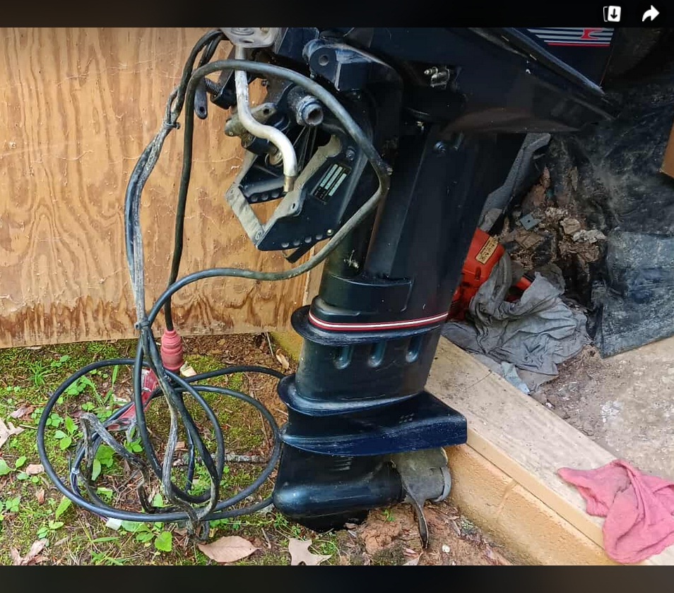

not sure what I'm looking at appears to be a thick battery cable. not sure what it's main wire harness looks like? appears to have the steering arm.
doe's this engine need a binical? an control cables to shift gears an throttle control?
response from seller "Has no switch, it plugs straight to the control. Worked perfectly when switched to a bigger engine." not sure what shes saying.

the binical isn't included. I assume the wire's attached to engine are in fact the main wire harness an the red plug plugs into this old fashioned binicals red plug correct?
I also found out I can use any newer BRP binical w/ P/N 768411 adapter harness.
now I have a newer BRP binical from previous main engine. just need the adaptor or can I make my own?
I now see there is an electric starterView attachment 34956
thanks racerone
The one large cable is your red plug, which contains all the wires for start, stop, tach, kill switch, etc. The other two are the + & - battery cables. I don't see the shift and throttle control connections in the pictures, but yes, the setup on this engine will require remote binical controls to operate along with a steering connection.
My guess is the sellers comment is simply there are no start/stop controls mounted on the engine, it is only setup to work remotely.

In order to use this engine I need the proper wire adaptors to connect to a binnical or buy a old binnical w/ the harness. like will any harness w/ this red plug be plug an play for this engine?
