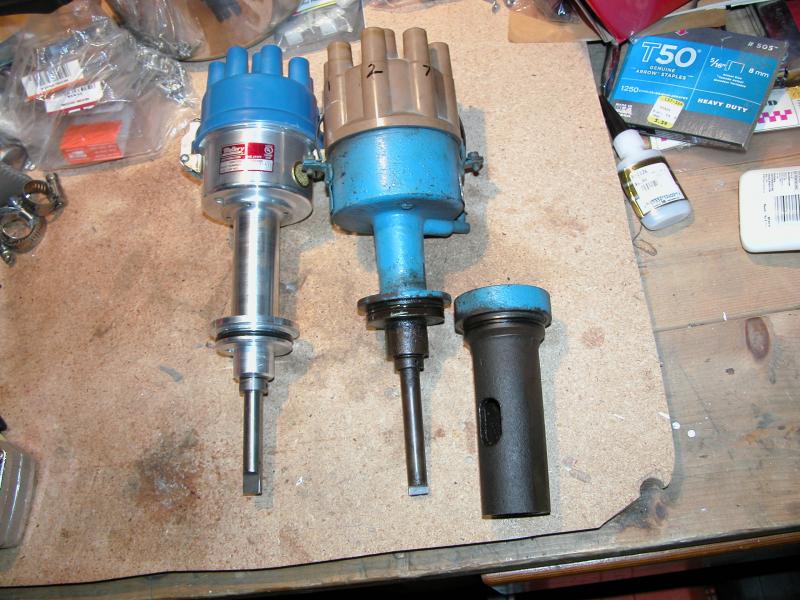

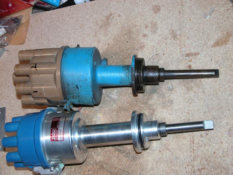

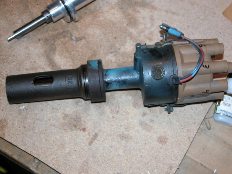

I am trying to replace the distributors on both my standard and reverse rotation engines. The springs inside are rusty and I don't trust that they are working correctly. I am currently working on my starboard (reverse rotation) engine and have not touched the port engine yet. I just had the heads rebuilt by a machine shop that does a lot of marine motors. My original heads had cracks around the spark plugs probably caused by heat, bad timing, or possibly bad timing advance. Whatever the cause was, I don't want it to happen again. I am trying to eliminate the possible causes.
I was given a brand new Mallory YLM578 AV marine distributor. Mallory says that this distributor will work for either the standard or the reverse motor. I pulled the reverse 440 distributor and compared it to the Mallory and they don't match up. I called thier tech support and they say that this is the only chrysler 440 marine distributor and it should work for either motor.

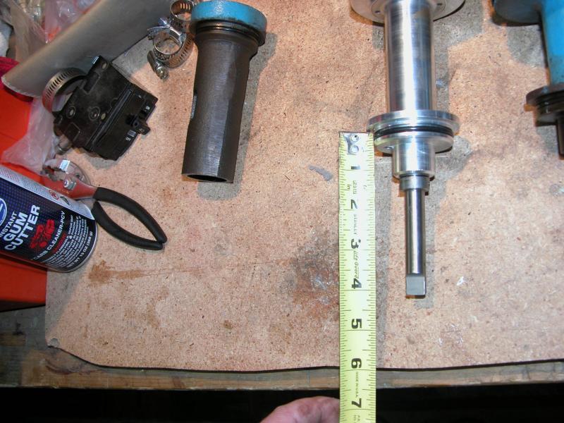

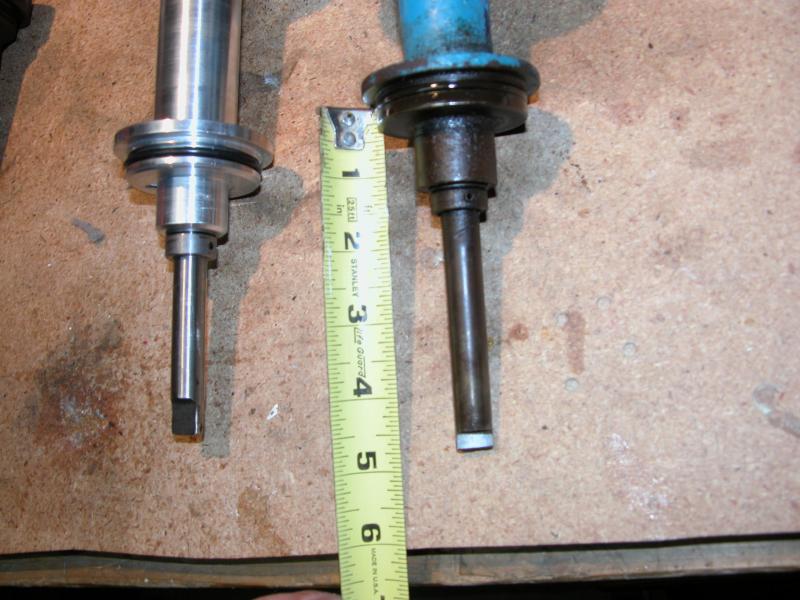

The distance from the base of the distributor (just above to o-ring) to the end of the shaft is different. The original distributor measures 4 3/4" and the new Mallory measures 4 1/8" long.
Even if I left the "thrust bearing" off, it would still not be the correct length.:mad:I don't know why the reverse motor would need a thrust bearing. There is no gear on the end of the shaft that would create thrust. I am confused and frustrated.....
Does anyone have experience with this? Any ideas???:confused:
The original distributor has a tag that says CHRYSLER 3675632 and under that DH 7003A 15 5. Another tag says MARINE SAE J354.

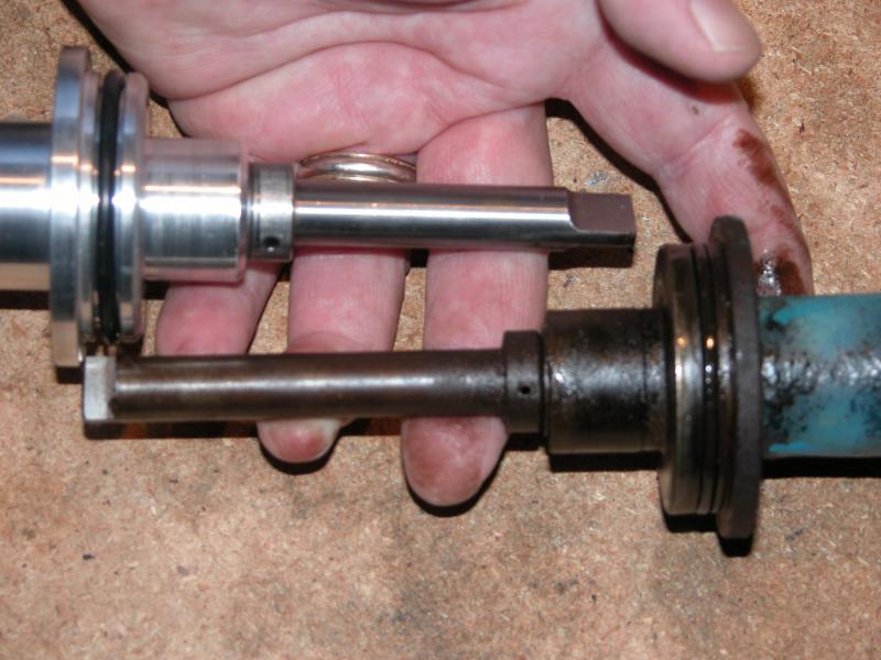

The purpose of that thrust collar is to hold the oil pump drive gear down on the reverse engine, it is not really need at all on the standard rotation engine. Since the cam turns in the opposite direction, but the oil pump must turn in the same direction the gear is cut opposite on the cam shaft and the oil pump drive gear. This makes it want to rise up, the thrust collar holds it down. Without the thrust collar it would drive itself upward destroying the distributor in a short period of time. The distributor has weights in it that are directional sensitive, you cannot reverse the rotation as you will not have any advance.
Basically you have 2 options for the reverse engine. A factory electronic ignition system, or, if you can find one, an aftermarket reverse direction with a long shaft to make up for the thrust collar, I have never seen one. Also the 383/400 distributor has a shaft with a slightly shorter length than a 440. They are 3 7/8", a 440 is 4 1/8" So mixing them up won't work either.
Shortly I will be posting a completely programmable, distributor less ignition system upgrade for the 383,400,440 engines that can be used in either rotation. It works great and with a laptop, or even a smart phone, you can change the timing curve, specs anyway you want. I am using this in our fuel injection system.
Anyway, do not put a distributor in the reverse engine without the thrust collar. You could always take the distributor to a good auto electric shop that has a distributor machine and have it cleaned and set up. The old Ma Chrysler stuff was well built, but it all need love sometime.
Good luck.

I spoke to Scott at Mallory/prestolite again. He now says that he can special order a YLM 5000AV marine. He said that it has a longer shaft that will work with the thrust bearing. I ordered it today. Supposedly these distributors can turn in either direction. My current distributor turn counter-clockwise in this reverse rotation motor. The new distributor is $329 plus shipping. I was given a price of $275-300 to rebuild the old distributor. I figure that it is better to have 2 new distributors with the same advance curve.
I tore down my port engine and found it has the same 4 3/4" shafted distributor? The thrust bearing stays inside the block on this engine. This is a standard rotation (CCW) chrysler 440.
I thought that the standard engine would take the 4 1/4" shafted distributor that Mallory says will fit the chrysler 440. This is strange.....
Ed, the 440 should rotate the distributor and oil pump CCW (when looking downward) regardless of engine rotation.
The camshaft "drive" gear and the distributor "driven" gear will correct the distributor rotation for a REV RH Rotation engine.
I thought that the CCW motor would not have the thrust collar and therefore would not need the rare 4 3/4" shafted distributor. My understanding was that only the CW motor needed this.

Yes, that sounds correct. Both engines turn the distributor CCW. I was surprised to see that the CCW motor has a thrust collar also. Both of my engines need the extra long shafted distributor. In my case, the standard Mallory 440 distributor will not fit either motor. I guess that $300 was wasted on the YLM 578 AV. If the special order longer shafted distributor (YLM 5000 AV) fits my starboard engine, I guess that I will have to order another for my port engine. The YLM 578 AV Mallory distributor won't fit either motor. I don't want to run the port engine without the thrust collar or whatever it is. The engineers must have put it there for some reason. The reverse rotation engine makes sense.....the standard rotation longer shafted distributor is strange. The marine engine (or at least mine) must be different from a regular chrysler 440?
Hi Ed
The thrust collar is not needed on a standard rotation engine. Chrysler put it there so all the engines were the same. You can run with it, or without it for the standard automotive rotation. I do not use those collars all all, however we do not build reverse rotations engines anymore, we reverse in the transmissions.
That should answer your question
Dan

Hi
I did not apply the response to the reverse engine, lets put the reverse engine out of our minds for the moment. I only answered that the standard engine did not require the thrust collar, he must use it on the reverse engine.
To help him so he is not stuck with the short distributor
1 use short dist, no collar, std engine
2 use long dist with collar, rev engine
Or use 2 long shaft dist with collars, both eng as Ma Chrysler did, his option
hope its clear, sorry for confusion
Dan
Thank you......that answers my question.:)

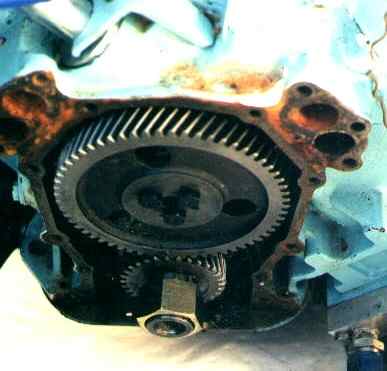

In this photo (below) of a M440, with factory installed cam and distributor, the Crankshaft turns one direction and the camshaft turns the opposite direction.
There is no thrust collar mounted under the distributor in the photo.
Sincere questions:
Q 1: Is this gear-on-gear driven camshaft in the photo below actually on the Std rotation engine? (the reverse roation engine is the one that runs the chain?)
Q 2: Does the camshaft on a Std rotation engine turn opposite to the crankshaft?
Q 3: Are there some PAIRS of counter rotating engines that run a Chain-on-gear camshaft drive on BOTH LH and RH ?
ie: Are there different configurations of cam drives from the factory on the 440's
The crankshaft and cam turn the opposite way in a reverse rotating engine.

A Mopar marine 440 (as in the photo) is different: In THIS case the crank rotates opposite to the cam thanks to the gear drive.
Perhaps THAT is how Mopar did their reverse rotating 440? (Don't really know.) Using the gear drive for the reverse rotators, while retaining the chain drive for the normal rotators, means the distributor and oil pumps will still turn the same way. If that is the case, then the thrust collar would NOT be needed for the reverse rotators.

I put the YLM 5000 Mallory distributor on the reverse engine. When I tried to slide it into place it would not seat all the way against the thrust bearing. It was sticking up about an 1/8". I once again held the new Mallory up against the old distributor that came out of the engine to compare them. It turns out that the shaft on the new custom built distributor was 1/8" longer than the original one. The extra length was in the tab like tip at the end of the shaft.The point (distance) at which, the round shaft started to transition into a flathead screwdriver like tab,was the same. I took a side grinder and ground off 1/8" from the tip. They were now exactly the same length. I bolted it in place and it has been running happily ever since.:D
Good deal. I assume Mallory installed some type of thrust bearing inside their unit to absorb the thrust load.
Correct!
This keeps the camshaft rotating in a standard LH engine rotation direction.
However, the RH Rotation engine camshaft "profile" is completely different from that of a Std LH Rotation engine camshaft "profile".
No.... with chain drive, it can't help but rotate the camshaft in the same direction as the crankshaft.
If twin sprocket chain driven, NO!
I can't speak for the Chrysler engines, but we will see an array of methods used for driving a camshaft.
Chain/sprocket drive, twin gear drive, four gear drive, etc.
The one pictured below, is a twin gear drive, whereby the crankshaft and camshaft rotate opposite from one another.
On a Mopar 318/ 360--that have a timing chain drive--the crank and cam turn the same way.
I think that Jeff nails it.
If this was any other engine, the same would apply with a double gear drive as pictured above.
It would not apply when the "drive" and "driven" gears are used with side idler gears...... (I.E., four gears)
In this case, the idler gears would bring the rotation back to the same as the crankshaft.
Jeff, correct me if I'm wrong here..... but it would seem to me (with twin gear camshaft drive) that both of his ignition distributors would be the same p/n.
