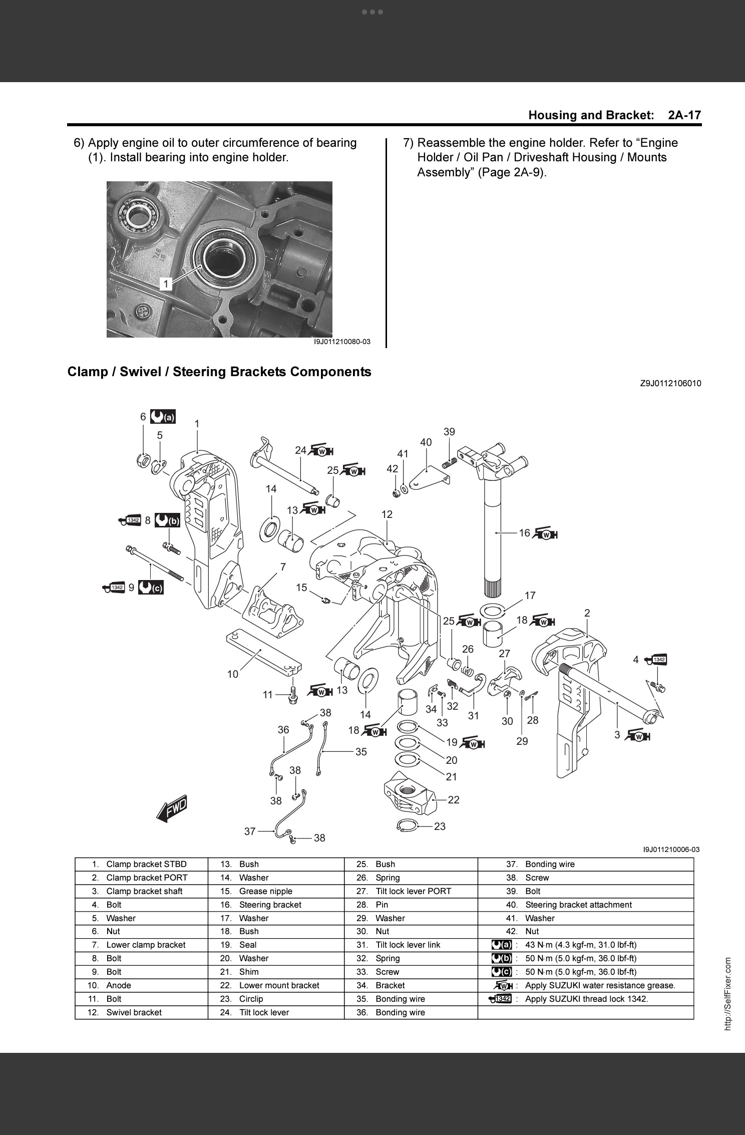

I have read that a heat gun to soften up old grease might help depending on how much corrosion vs old grease is causing you grief. What they did was warm up the area around the steering bracket, pump grease in, turn the engine a bunch of times, repeat. Looking at my service manual(2009 DF-90A)the engine has to come off to access the steering bracket. Should you need to disassemble selffixer.com has a service manual for your engine.
Thank you William for the tip on using a heat gun, but I believe that I would still have the problem of getting the grease to make it to the top bearing or bushing because of it coming out the bottom of the shaft. Looking at the diagram you attached, it appears the the top mount is a sealed bearing, am I correct?
Never had mine apart so I have no first hand experience. I don’t see any bearings in the Clamp/Swivel/Steering Brackets Components parts breakdown diagram only bushings.
