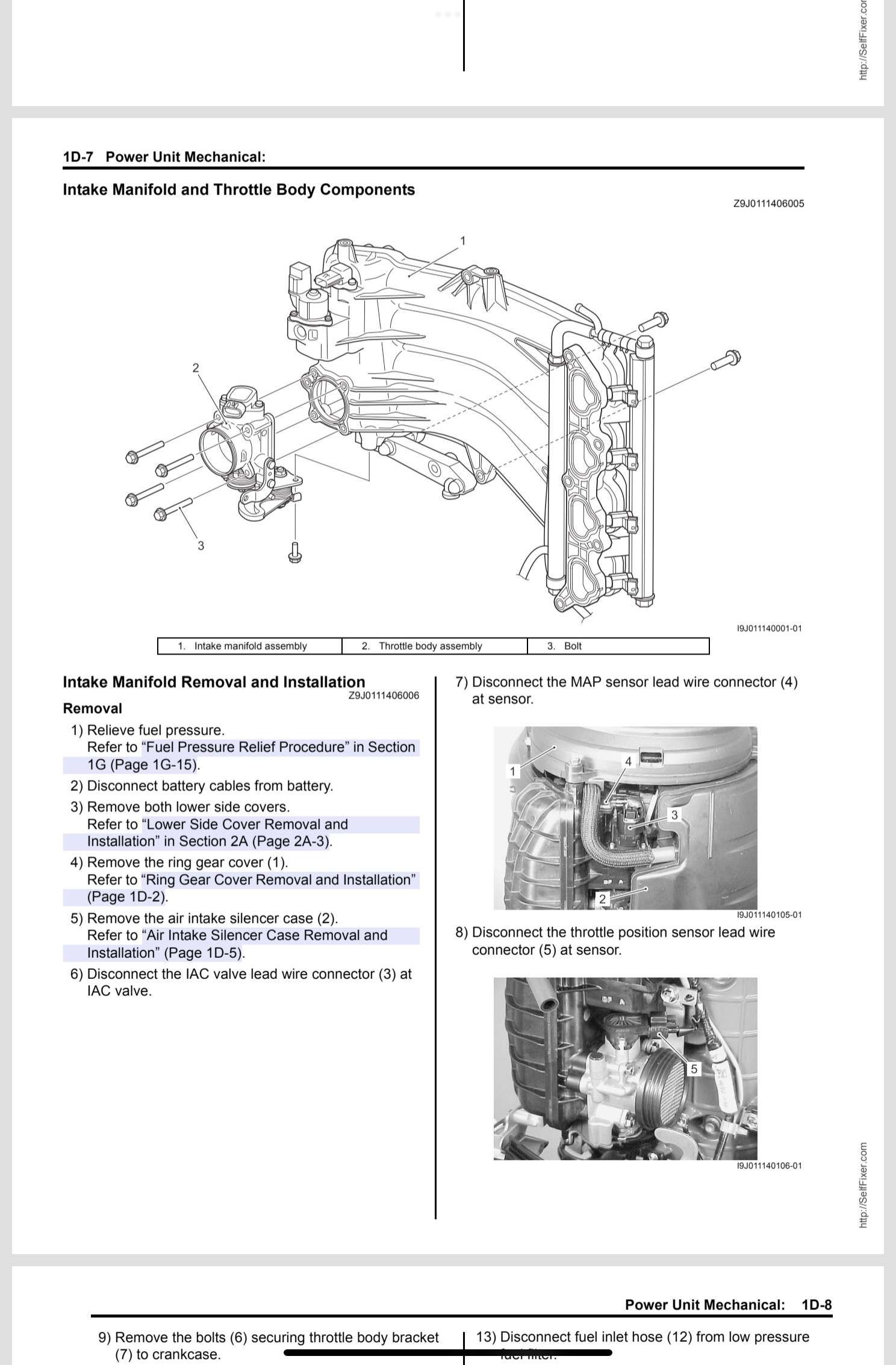

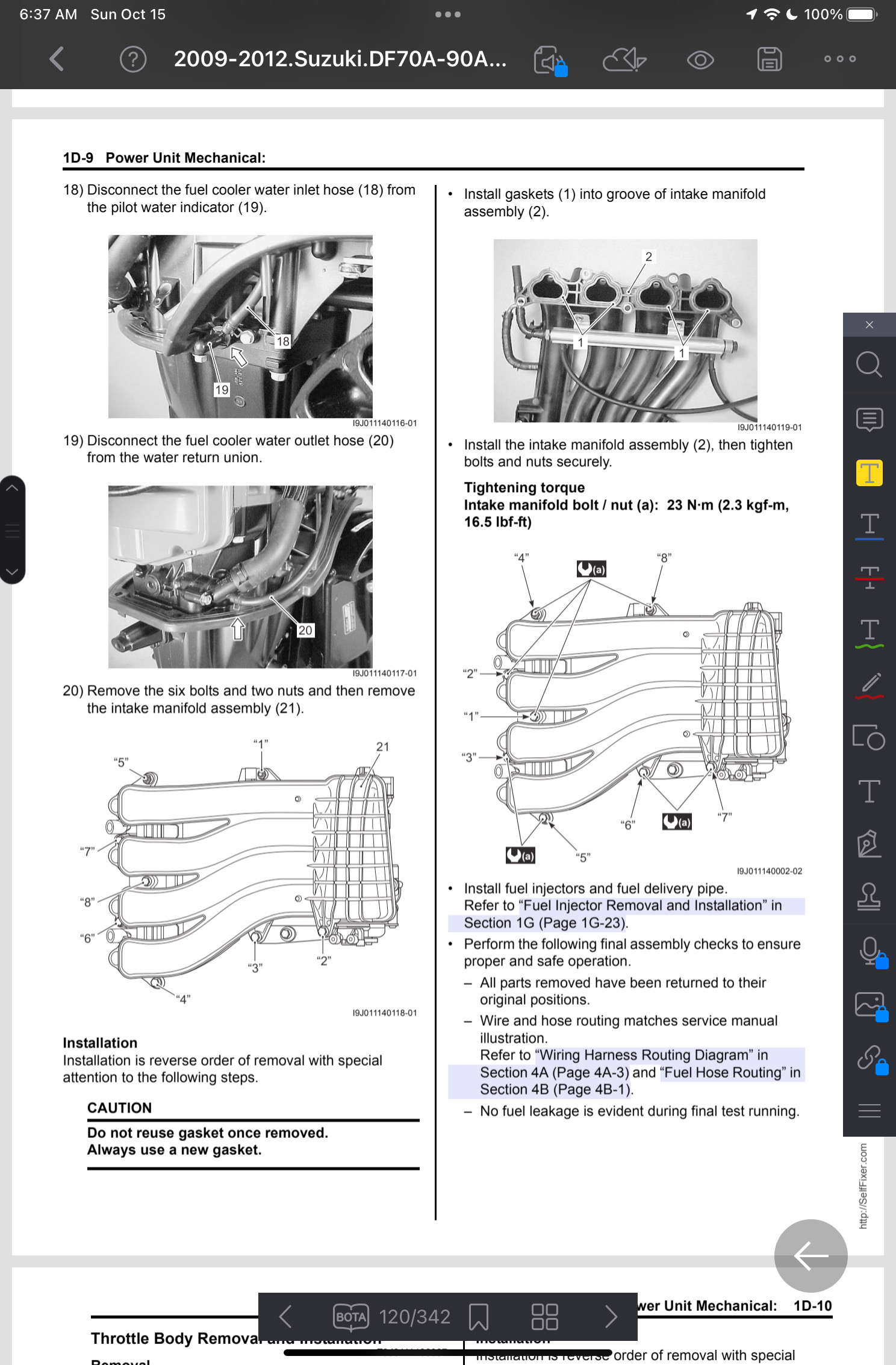

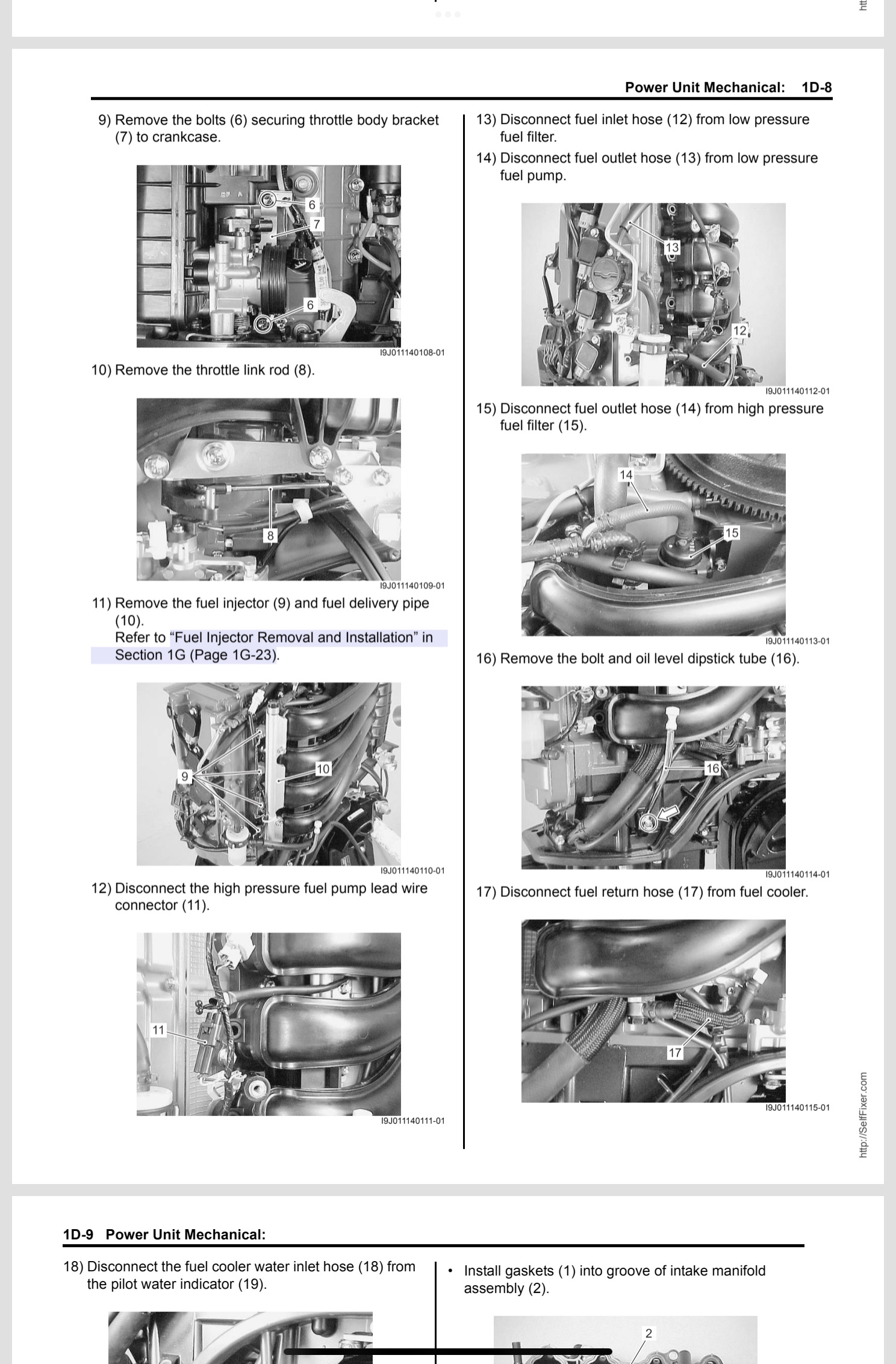

From a 2009 Df90A Service Manual. Not your engine but it might be close enough to help?
