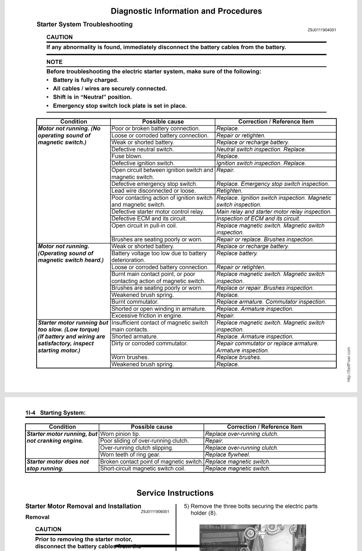

From a 2009 DF90A service manual.
Check all wiring connections for corrosion, pull them apart and check for corrosion including the wires at the battery posts, they should be shiny and tight. If your batteries are old and have been frozen they could be your issue even though they show +12V, if in doubt have them load tested. On my 2009 engine I have 3 fuses, a 15A, a 30A and a 40A, I’m assuming you’ll have the same fuses. Neutral safety switch is worth checking. Ignition switch and kill switch could also be acting up. The hum your hearing is likely the high pressure fuel pump pressuring up the fuel system.
