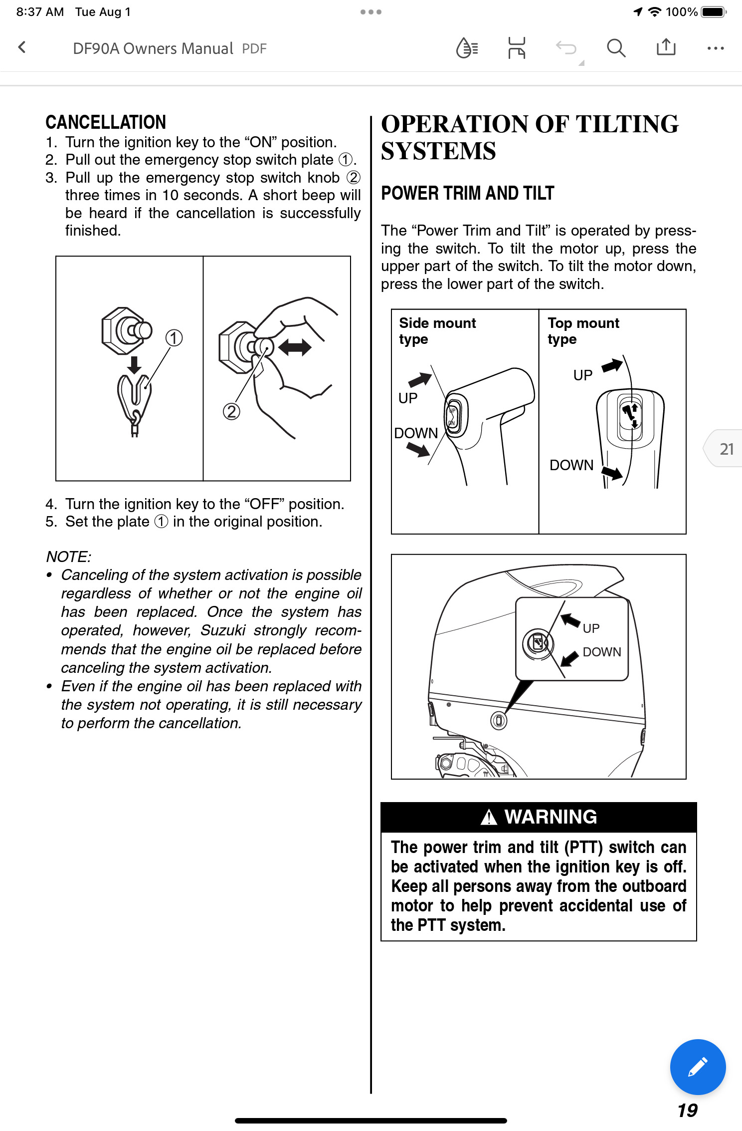

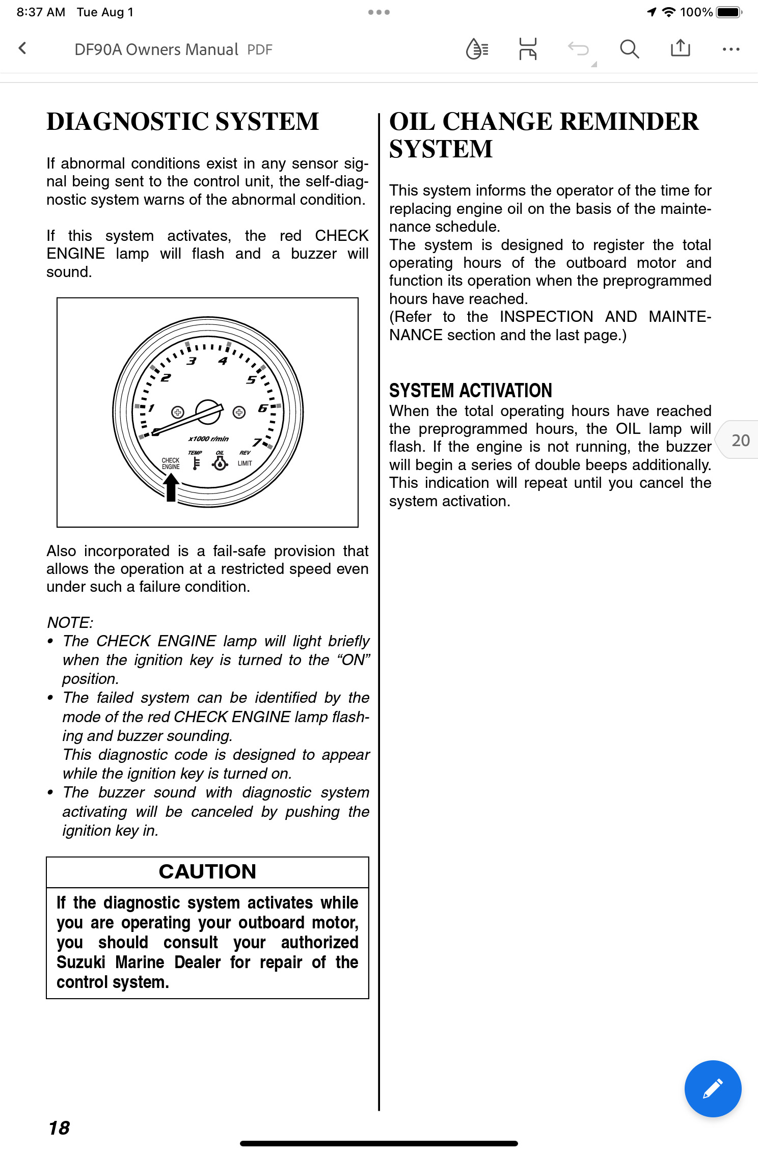

captbill
I believe your engine has a oil change warning based on preset run time. Perhaps your light is saying it is time. If so, it has to be reset when you actually change oil so it can start counting again. Check your owners manual for the reset proceedure. I have forgotten how, and the manual is in the boat.
Sorry, I should have included the info that I reset the oil change warning system when I first noticed the blinking light.
Thanks for the response though.
