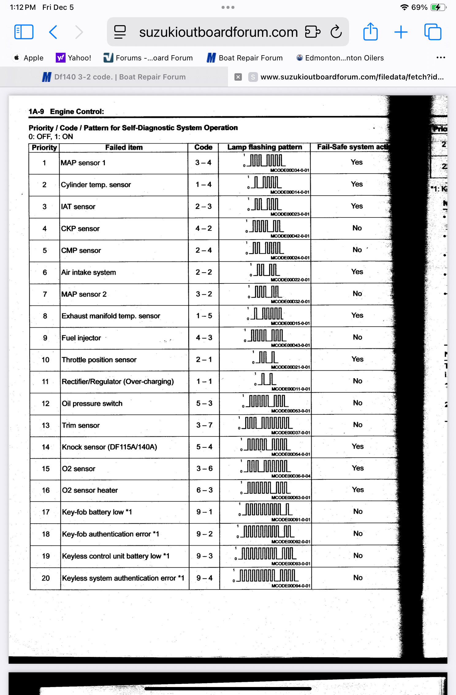

I baught a used 2013 df140 it throwing a 3 2 code which should be tps the only problem it appears to have a 2012 throttle body on it and im having trouble finding the senor it not on the top of throttle body or on the sides abd the only plug I can find is a triangle 3 pin plug that's not plugged to anything any help with picture or location would be greatly appreciated
Throttle Position Sensor is a 2:1 code?
On my engine(2009 DF90A) the TPS is on top of the throttle body. It does take a 3 wire plug.
