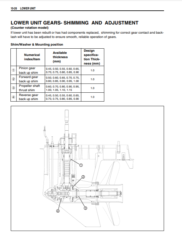

i got mostly everything reinstalled yesterday and was feeling like this was way to damn easy so i popped open the manual and sure enough i may need to do some things. so help me please

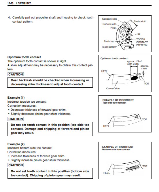

manual says i need to GEAR SHIM AND CHECK BACKLASH.... WTH
1. i need help i think. so if yall have easier ways to do this tell me and please explain...
2. if i can get away without having some of these tools please fill me in on alternative pieces?
imo these are kinda what i need but am gunna try and buy through a dif company so please fill me in on some alternate items i can buyinstead of this over priced stuff the stuff with the dash i am preparing to buy but is there alternative parts then the suzuki stuff its crazy for the price
it seems i need these tools
-#11 09900-20602Dial gauge (summit racing$20)
-#12 09900-20701Magnetic stand (summit racing $20)
#13 09900-20803Thickness gauge (do i need this? Suzuki)
#20 09913-50121Oil seal remover (dont need)
-#21 09951-09310Gear adjust springset ( i need this for some reason for the counter rotation lower why is this not needed on the othermotor? is ther an alternative to $340 suzuki part?)
#22 09921-29410Driveshaft holder ( dont need)
#50 09930-30104Sliding hammer (dont need)
#51 09930-30161Propeller shaftremover ( i didnt use this to take it off should i have should i buy one?)
#52 09926-29310Driveshaft housingremover (dont need but it could make things easier? is it worth it?)
#53 09951-99310Gear holder ( i feel like i need this but do i really?)
#64 09950-69512Gearcase oil leakagetester (need this or something similar, recomendations?)
- #65 09951-09511Gear adjustinggauge (suzuki $470, there has to be a alternative part for this recomendations?)
- #66 09952-09310Back lash indicator tool ($90 need this from suzuki right?)
just trying to save some money and ensure the money i already spent isnt gunna go to waste. i plan on doing the other lower unit when this one is purring again.. thank you for any and all advice and pointers
