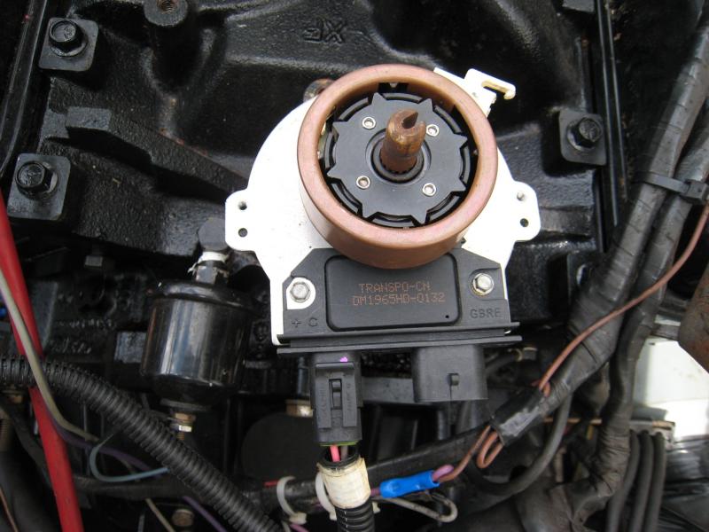

I've got a Delco EST distributor that I suspect the pickup coil is bad. One of the leads shows resistance to ground, should be infinite. So I'm having problems on removing the pick up coil. I've got the cap and rotor off, disconnected the wire leads. I've got a service manual that says to pry off the retainer. Don't see any retainer and pickup coil doesn't slide off on the shaft. Does the shaft need to come out of the block to remove the pick up coil? Attached a photo. Help appreciated.

Reread the service manual...you'll need to pull the distributor. then the gear and the shaft...the retainer will be visible once the shaft is out.
Thanks. The service manual had the distributor removal in a different section. For the pick up coil it mentioned removing the rotor from the upper end, disconnecting the leads from the ignition module and then prying the retainer free. A diagram shows the retainer sitting on top of the pickup coil. That's why I was thinking it might be able to done without removing the distributor. Didn't want to remove the distributor and then need to reset the timing unless I absolutely had to. But I do, so I ordered a new timing light that has RPM and Advance. MY old timing light was only a light and had to look at the flywheel for advance. The job just got more expensive and complex.

Hello,
you have to remove the distributor and remove the gear. Then the rotor shaft will slip out . There you will see the retainer clip that gets removed before the pole piece is removed.
be sure to set the #1 cylinder on TDC or 0 TDC before removing the distributor. Check location of rotor and that it is pointing to the #1 pole on the cap. It will be much easier when reinstalling and getting initial timing.

Mostly - yes....I suggest bumping the engine until the rotor is close to #1 and then rotating the crank until the timing mark on the balancer is @ TDC and then doing the distributor swap....no need to pull the rocker cover.
Mark is correct! It is much easier to begin with #1 at or near TDC on the C/S.
Using my method for "first fire-up ignition advance", I will typically stop the crankshaft at about 6 degrees before TDC.
This gives us some spark lead that ensures start-up until the BASE advance can be set.
