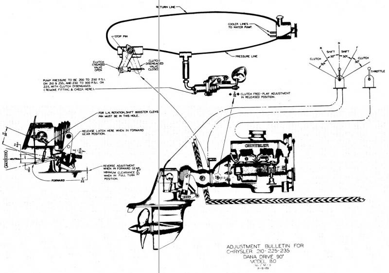

Hello I'm trying to adjust the clutch on my 71 Gibson houseboat with a 318 and dana outdrive with a hydraulic clutch. I'm hoping for some setup instructions so I can adjust the cable that operates the valve in the hydraulic line that operates the slave cylinder. It seems to work except when idling in neutral, it pushes the oil out the cap on the power steering pump. Any help or ideas anyone??
