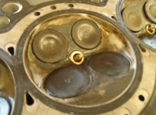

After sitting on the stand in my shop for a year I finally got to the motor and started tearing it down. Took off the starboard bank cylinder head where the knock seemed to be originating this morning and wow. Middle piston is trashed. It looks like a valve dropped in and went around for quite a few rotations before either it shut the engine off or someone shut it down. Cylinder is clean, no debris at all came out when the cylinder head was removed.
The dealer never mentioned anything happening, piston lining is scored.
The troubling thing is that all four valves are intact and in perfect shape. The cylinder head on that hole looks fine.
I expect they replaced the cylinder head between sea trials and never said anything. I imagine it bent the connecting rod and took a while for the bent rod to wear through the bearing enough for it to start knocking.
Wanted some advice from some with experience on what is best course of action? Can the cylinder liner be replaced along with a piston and rod? Is it likely that the crank is fine after such an incident? Is a short block the best bet in these instances? The cylinders on the other two pistons look brand new. Not even a hind of any wear on the sleeves. I suspect the engines really do have low hours but have sat for 10 years which is probably worse than running hard.
Any suggestions or past experiences would be welcome. All valves look to be seating fully and properly, I expect this is a different head than the one that was on the engine when the piston was damaged. I have attached a photo of both.
