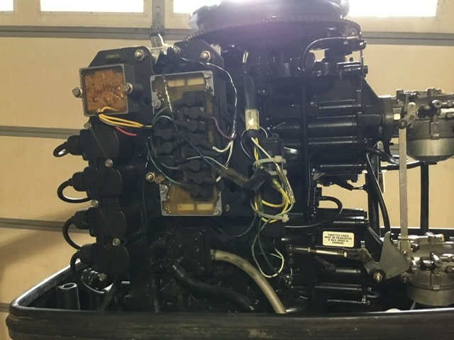

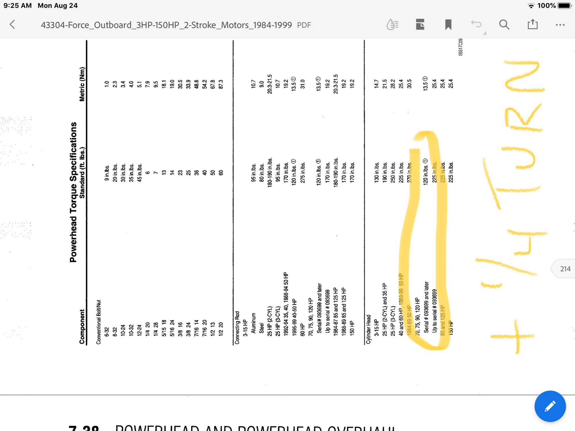

I have what I THINK is a 95 Force 120. The serial number tag is missing. Someone told me to look at the date on the starter which is “8 04 94”. When I look up the specs I see 120 ft. Lbs plus 1/4 turn and also 225 ft pounds. It seams to change around 95. I wouldn’t be so concerned but obviously if I go with the 225 I may break bolts and if I go with 120 water may get into the cylinders. Here’s a pic of the engine.
