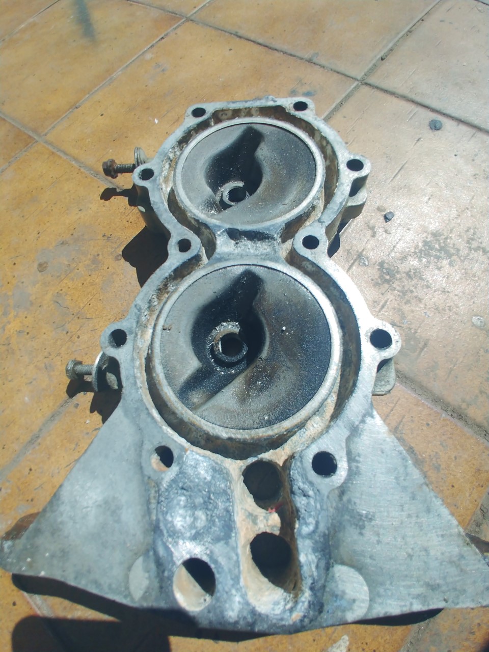

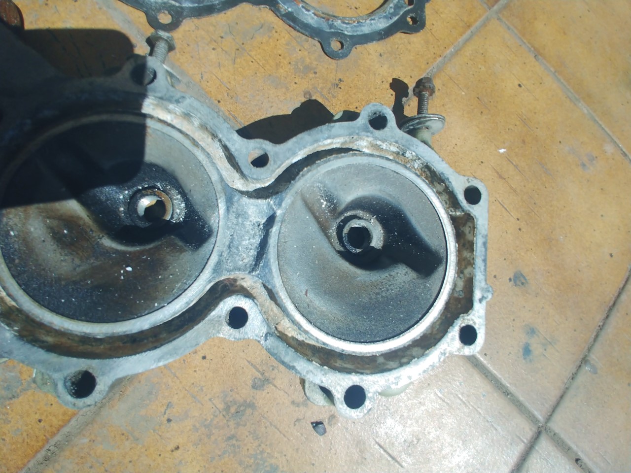

[FONT=&quot]Hi guys, bit of a novice here from Melb Australia. Have had this 1975 Evinrude 50 running quite well for a few years but rebuilt the carbs with new kit and replaced cylinder head gasket . Ran well for a while but noticed it bogged down when I tried to go full throttle . I have stripped it down and noticed corossion between the two cylinders . I'm not sure if it was there before? I think there was a bit of a hole but the salt water seems to have made I worse. Can anybody advise me what to do? I had a feeling I may not have retorqued the cylinder head bolts after running it and that's why the loss of power ? As I said , I'm mechanically minded but new to outboards. I've attached some pics , Any advice would be great! Thanks in advance , Ash[/FONT]

You could take it to a mahine shop they will tell ya if its too far gone or not, do the bores look good is it worth spending money on is what would be going through my mind,if the heads like that whats the rest of it like,food for thought,cheers
I just sent a 1969 Ford Mustang part to a guy in Australia. It goes to Kentucky first, then overseas. He bought the part from me on eBay. It was $60 and I charged him $20 shipping.....he covered the rest but I don't know what the excess cost was. Want me to check with him to see what the shipping proceedure involves? He is in Victoria. I have a head around, I think too. Its likely the new gasket didn't seat well once the corroded area was disturbed. Actually, I could recommend an experienced mig welder that may be able to fix it, then reface head, but sadly....he's talking to you from about 7000 km away.

Could I try JB Weld and reface it? The bores look fine , I think I just didn't torque it down properly .
i have also been working with similar problem with my 3hp. During rebuild i noticed that cylinder head was eaten from the same point, but much more, and there was like small deep hole. I put "new" used, but good, cylinder head from my 3hp johnson, which i have bought for parts. Same motor saved the life of my 3hp Lightwin, since i also took good pistons from that engine. Other parts of my engine are corrosion free.

You could yes. My advice if you go that route is make sure all to corrosion is removed. Otherwise it will creep under the JB Weld. Otherwise like TimGuy said send it our way and either Tim or myself could weld it and flatten it.

It cost me 150 a head for reface and welding work , ebay the shipping will be more than the part and summer will be gone before you see it, take it to shop wed you be fishing fri have a good straya day .cheers
