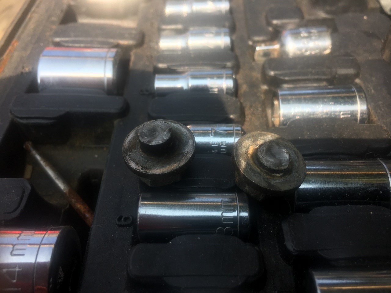

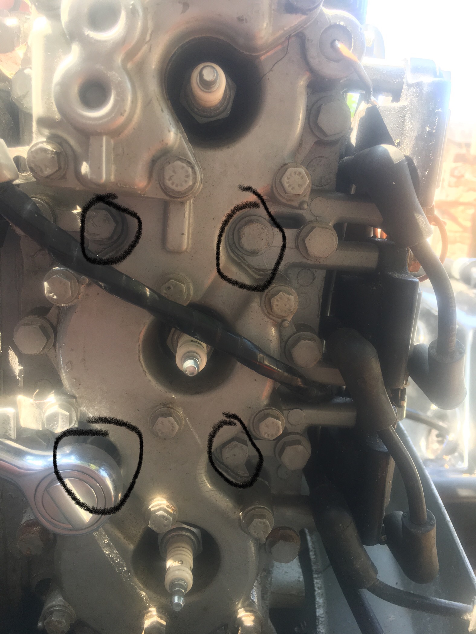

Guys iv started now and the 4 bolts in the photo I can’t get them off I’m worried il brake something. Iv tried heat and hitting with hammer to try to shock it. Not sure how much heat I can apply. The other 14 have all loosened fine
Any tricks you may know of?
