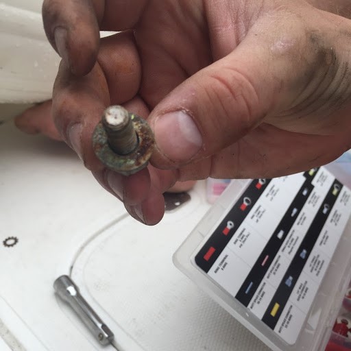

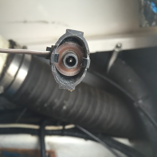

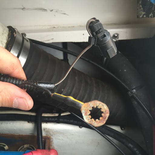

He said his mechanic thought it was the MAP sensor, which would make sense as this controls how much fuel is injected to the cylinders (ie the boat was bogging down like it was starving for fuel). When i located the MAP sensor and ground terminal (on the starbord side of the starbord engine - a b*tch to get to!!!) I noticed that the ground terminal and screw had a decent amount of rust and buildup on it. See attached pictures. For what its worth the port side looked very clean.
