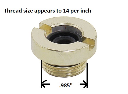

I measured a used one I have.
Thread peak to thread peak diameter was .985"
I used a thread gauge and measured threads and they appear to be 14
so I would think the tap you have is correct.
I would ask, Which shift shaft seal bushing did you purchase?
The correct one is Item 49, click on link
http://www.marineengine.com/parts/m...5577-thru-0d469858/gear-housing-driveshaft-mr
Thanks kghost. That's very helpful. I actually got a response back from a query I sent to Merc, and it's the same. I double checked the bolt that I bought and lo and behold, it is not a 14 tpi. So, somehow I got a bogus bolt.
To answer your question, I have bought one of the composite aftermarket bushings. Do you have experience with these - positive, negative?
