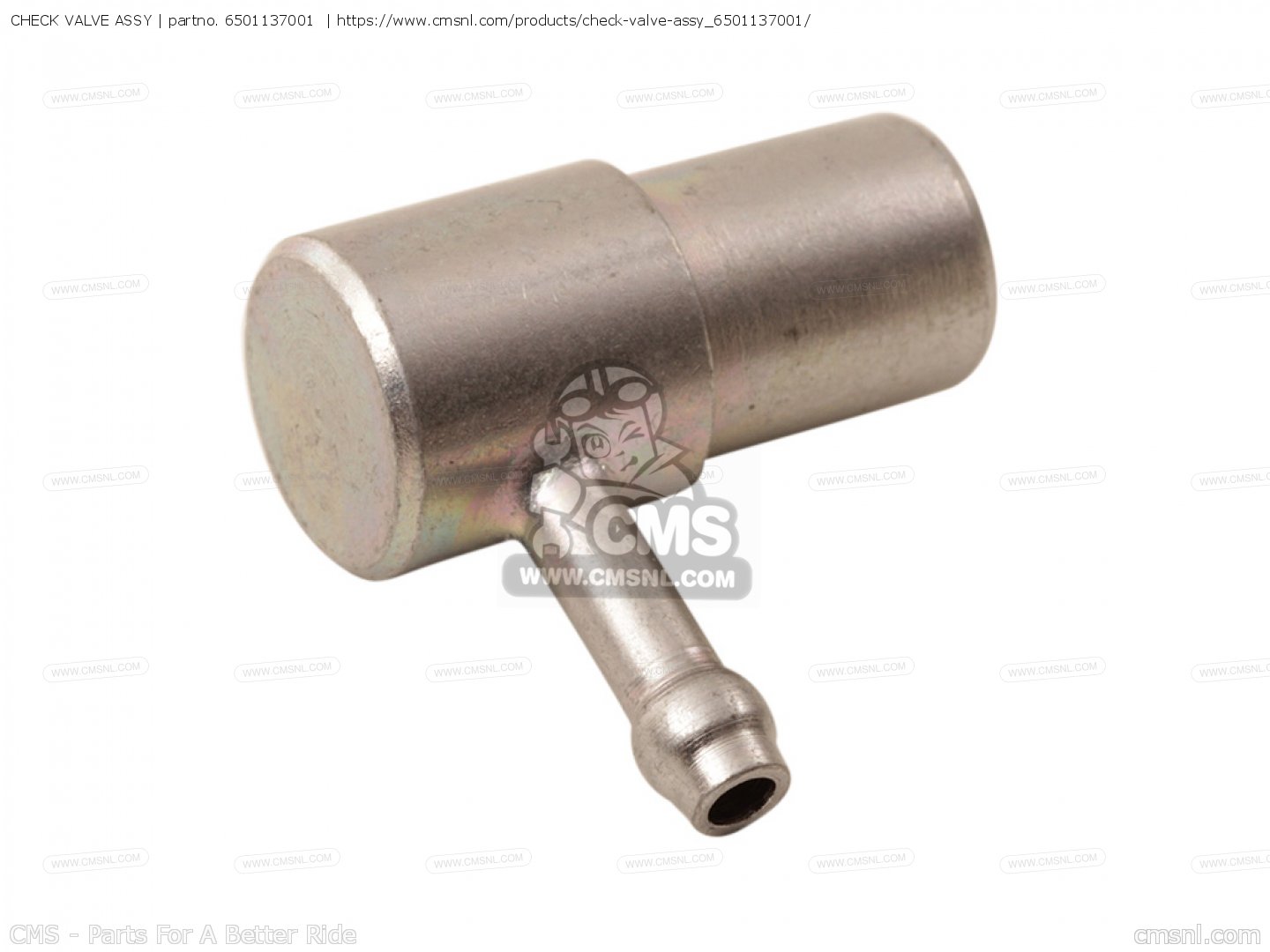

I have corroded Crankcase Valve Assys on my 1995 Yamaha 70hp 2 stroke. I’ve found replacement parts, but no idea how I remove the old and replace them? They have no threads.
It’s only two I need to change.

Seems to be a press fit.
Using an extraction tool (Vice Grips come to mind) pull the old part out.
Then use a percussion tool (hammer comes to mind) to insert the new part.
Might help to heat the section of the block that surrounds the part (and/or chill the old/new part) to help with the removal and insertion.
