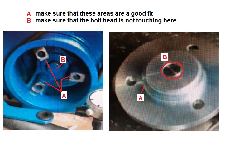

Bob, a few suggestions:
First.... use your dial indicator and check other areas on the balancer for run-out.
..... check the inner ring area.
..... check the outer ring area.
..... check the serpentine belt area.
This will let you know if the balancer itself is tweaked or if it's OK.
See if the relief cuts (within the center area of the balancer) allow for the seawater pump's flange to fit properly.
Look for any interference at these areas (see image below).
Check not only the diameter, but also the depth of these reliefs and at the bolt head area.
If those areas are good, remove the balancer.
Take it to a machinist so that he can turn it in a lathe.
He can then check the 3 mounting flats for run-out.
If need be, he will make a cut on the 3 flats to remove the run-out.
A few thousands cut may do the trick.
