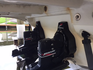

We have corrosion on the top portion of BOTH engine mount/gimbal assemblies. It is literally coming through and out of the Merc label. Looks like metal shavings... A mechanic we know says it is common and don't worry about it. I don't see how leaving corrosion is such a good idea...
Cause? Is it truly common? I believe the cure will have to involve a wire brush. Is it common to have to drill out the cover plate? If so - what metal plate/ gasket do I cover it with? Thank you anyone for your info - we've only had the boat a few months. image.jpegimage.jpg
Most likely corrosion from the inside from water getting past the seal . Is the steering arm rusty or have white crust on it? Thats a sign of a leak .I would reinstall the missing grease fitting to prevent this from happening.A easy job to do .I have a video on it using a GEN II housing. No need to remove the drives or anything .
Hit the housing with a wire brush to remove the corrosion. and spray with some Black epoxy appliance paint.
Should you go thru google JR Bravo repair. I just installed 2 on a twin engine from electrolosys damage .
I would tape the plate to the housing to locate the holes and not use the paper template , drill and tap 1 hole, install the bolt, then diagonally drill and tap and install the other corner bolt, then locate and drill the 2 remaining bolt holes.No need to open the transom to install the plates.
Verify all the bonding wires too ,outside AND inside the boat
