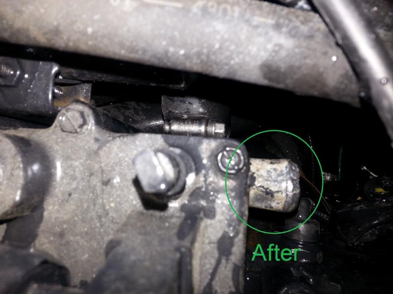

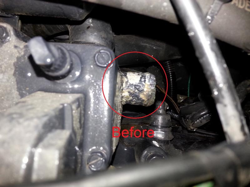

At least I think it's a oil cooler. There are a couple of coolers at the top rear of the engine.(1995 Ford 5.8) One has 2 small lines entering from each side for either oil or Power steering I believe. has a water hose that comes out and goes into another cooler. The hose is "U" shaped and maybe all of 6" long. Anyway I noticed some white powder looking stuff at the end of one of the hoses like it had been leaking something. Tightened up the hose clamp and let it go for a bit. Just kept getting a little worse. Pulled the hose today and the fitting it attaches to was very corroded. I cleaned it us as best I could with some waterproof sandpaper. It's not visually stunning but it feels very smooth now. Question is, is there anything I can put on there like a corrosion inhibitor or paint to slow this process from happening again? Also, is there anything we can flush these engines with that won't hurt the hoses, impeller, etc.??

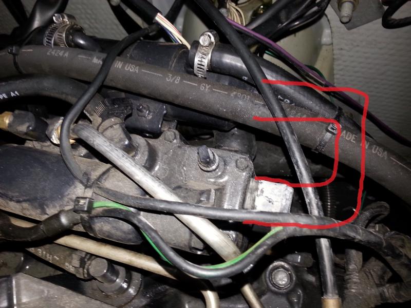

Here are a few more pictures for reference. The corroded cooler has a pressure relief valve on the top of it.
I would agree that that is what it looks like. Have never seen a water cooled fuel pump before. Just strange that the hose description is "Oil Cooler to Oil Cooler". Either way, I think I'm going to try to clean that hose connection up a bit more and then try to put some sort of Rustoleum on it to try to slow that pitting and corrosion.
Chris.... the Marine version EFI does not offer a fuel tank return as do the Auto versions, so the liquid cooling of the fuel becomes necessary.
