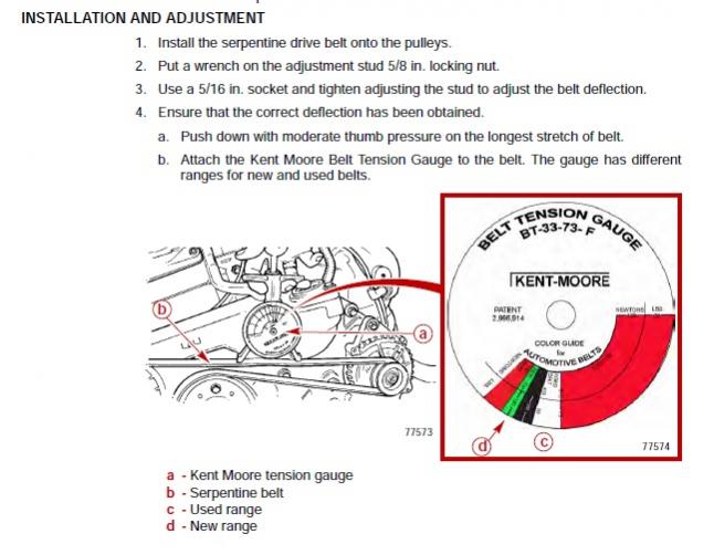

2014 Mercruiser 5.7 350 MAG Bravo, single serpintine belt: how do you know when you have the correct tension, is it by feel, sound, or do you take a measurement? Appreciate the help, I am an amateur mechanic
Doesn't it have a self tensioner? Spring loaded idler pulley? If not you should find an area on the belt that is a straight shot for at least 12 inches, and move it with your fingers up and down. It should have 1/2" play.
From service manual
Proper tension - 15-19 mm (5/8-3/4 in.) deflection, with moderate thumb pressure, on
the belt at the location that has the longest distance between 2 pulleys.
The absolute best way is with a belt tension gauge!
I dont think they specify it in ounces or pounds of deflection only in mm/inches

....Per manual..........
There is not a spring loaded pulley. There is a pulley with a little cog/gear that sets the tension, sorry I have omitted that. The belt is too tight now
