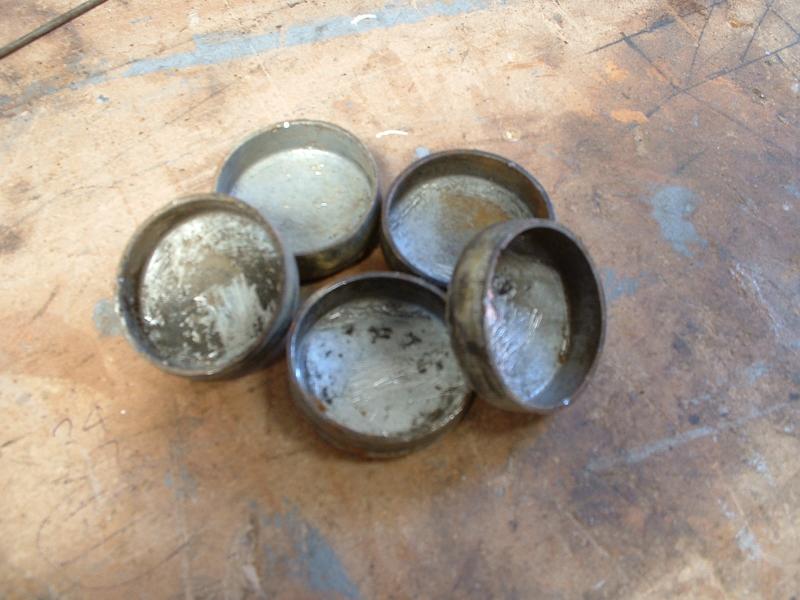

Job done! ... I found 5 steel core plugs that I have now replaced with brass. Fortunately the 2 behind the flywheel were found to be brass, so that saved some time. Interestingly the 5 steel ones all looked to be in servicable condition, free from any signs of corossion. Maybe the block has not seen much salt water or has been regular flushed with fresh water after use, so whatever the core plugs are plated with seems to have held up really well.
