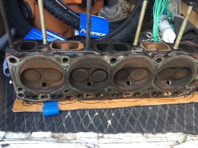

The burned rubber of the impeller is nothing compared to the damage to the exhaust tubes, exhaust bellows and the others if it's run long enough. My main bellows felt like silicone rubber when I removed it- it's supposed to be firm, but flexible. Most of the rubber parts are shown below- this damage also included the raw water pump housing, plastic water tube that slides into the water pump outlet, the water pocket cover (directly above the raw water pump) and if you think about how these work, the dry exhaust will do a lot more damage than having no water passing through the upper gearcase, which circulates the oil and has the aluminum lower GC in the water at all times (unless something really weird happens)- the oil is always losing heat to the gearcase.
If you look, you can see that the exhaust valve is slightly open- that's because it was bent.
