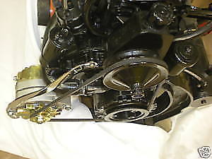

May we safely assume that you are wanting to dump the Merc 470 OEM charging system?
If so, you can buy a ready-to-go conversion kit that incorporates the Delco 10si Marine version alternator.
One kit places the alternator down low on the Starboard side.

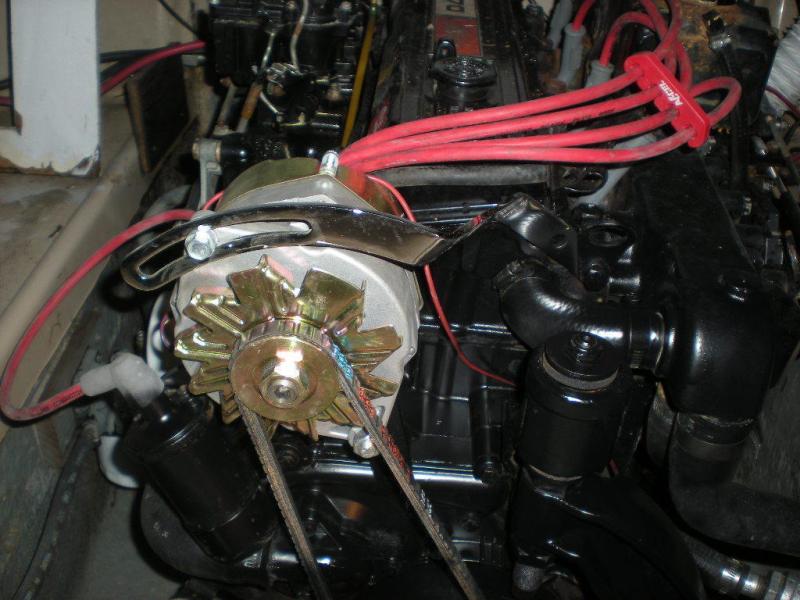

Another kit places it high.
The 10si Marine version can be had in what they call a "one wire" unit, or in the style that is externally regulated.
The one-wire unit must be rev'd up to self excite. Once excited, it will remain excited until shut down and start-up again.
