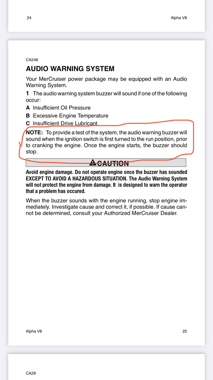

So after another phone call with Mercury Marine and them telling me it’s not normal and should not be sounding a continuous alarm before startup, I asked for them to send over the engine Owners manual.
Low and behold this is what I found:
I even asked the tech rep to look at the manual to confirm it can only be those three variables causing the alarm to go off. He must have not seen the “NOTE” just below.
The water temp switch and the low gear oil resevior sensor will NOT cause an alarm with ignition key in the on position as long at the temp is below switch set point and gear oil level is above sensor level.
The oil pressure switch see Zero pressure when engine is not running and that triggers the alarm.
As Dieter said once engine is spinning/running and oil pressure gets above ~4-7 psi, the oil pressure switch opens and alarm goes away

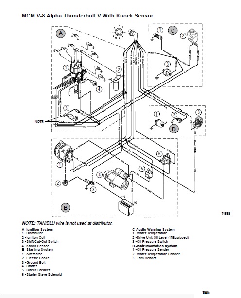

If you track down all tan with blue striped wires you should find one leads to gear oil resevoir, one to temp switch and one to oil pressure switch. If your oil filter is down and to the back of the engine on passenger side of boat, it may be very close to the oil filter. if not there it may be on the intake manifold near the distributor
Again the wire color attached will determine if its part of the alarm circuit.
Are the gauge wires also tan and blue because both of the temperature probes for the overheating circuit had a tan with blue stripe wire.
Here is the schematic. Its up to you to find the devices on the engine.

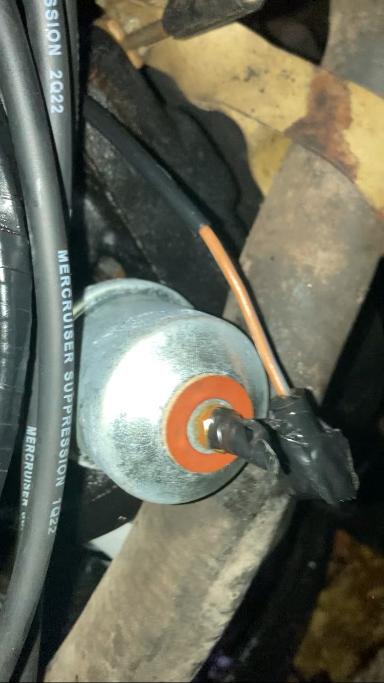

I found my answer today though. So, they didn’t actually replace the sender like the invoice says. They ended up replacing the oil pressure SWITCH with a sender (wrong part). Unplugged the tan/blue wire and viola alarm is gone. So we’ve got that part on order now.
Makes sense why he never had a startup alarm before as the invoice says the “sender” which was actually the switch, was never plugged in. My grandfather asked them to look into the oil pressure gauge since it wasn’t working so they replaced the gauge and what they thought was the sender but turned out to be the switch. Hopefully this makes sense!
It also turns out the oil pressure gauge sender is up by the distributor, and the oil pressure switch location is down towards the bottom and back of the engine port side.
Here a photo of the oil pressure switch location; you can see they used a sender instead of the switch (I wrapped electrical tape so we could launch the boat and stop the alarm):
Here is what it should look like:
I am curious, when we go to replace the sender with the switch, will oil begin to drain out of the block?

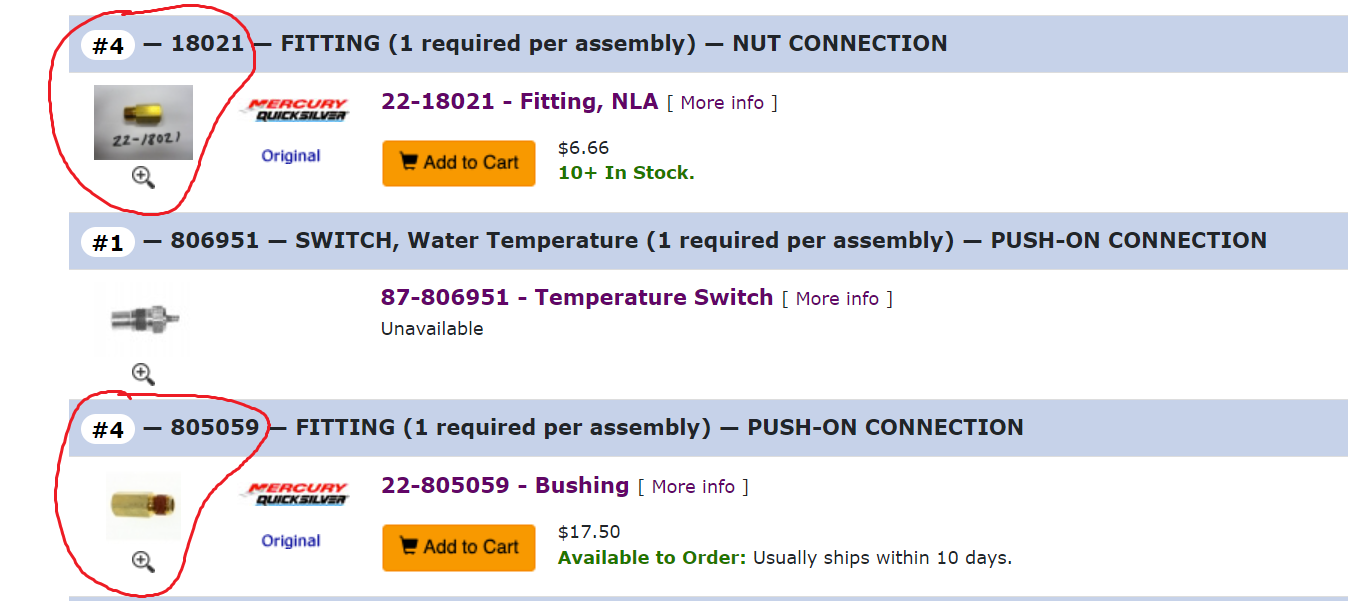

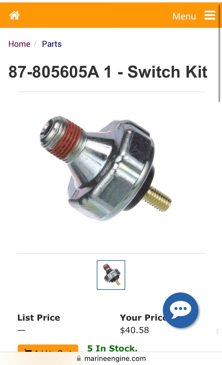

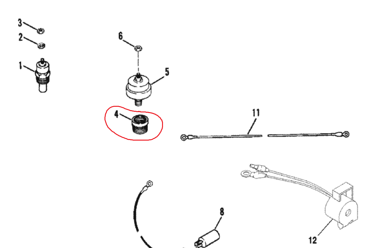

When ordering the Switch I noticed an extra brass fitting in the diagram. I do not have the original part to compare obviously so what do you guys imagine it is for? Is it necessary? There are two options as well, and one is three times the price of the other. I went ahead and just added the cheaper $6.66 fitting just in case I need it.
Are the two brass spacer/adapters different in any way?
