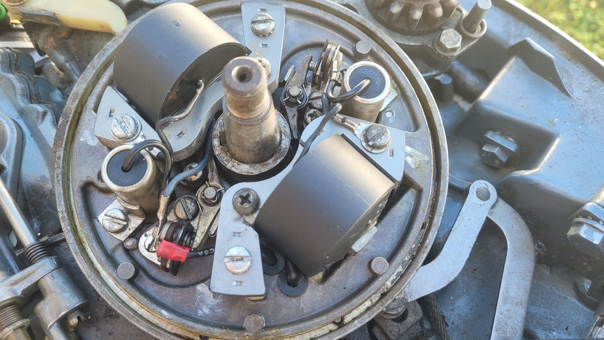

Regarding ignition, I pulled the flywheel and checked both sets of points. I ran an fingernail emery board between the surfaces and checked the gap for each was at 0.020”. Coils and wiring looked good. I reinstalled the flywheel and the key. I checked the sparkplugs. They appear to be quite new and they didn’t show signs of wear or fouling but I notice that they are Champion J8C and there appeared to be quite a bit of soot from running rich. These are probably hotter than is suggested by Evinrude but I don’t know what influence these would have on my problem.

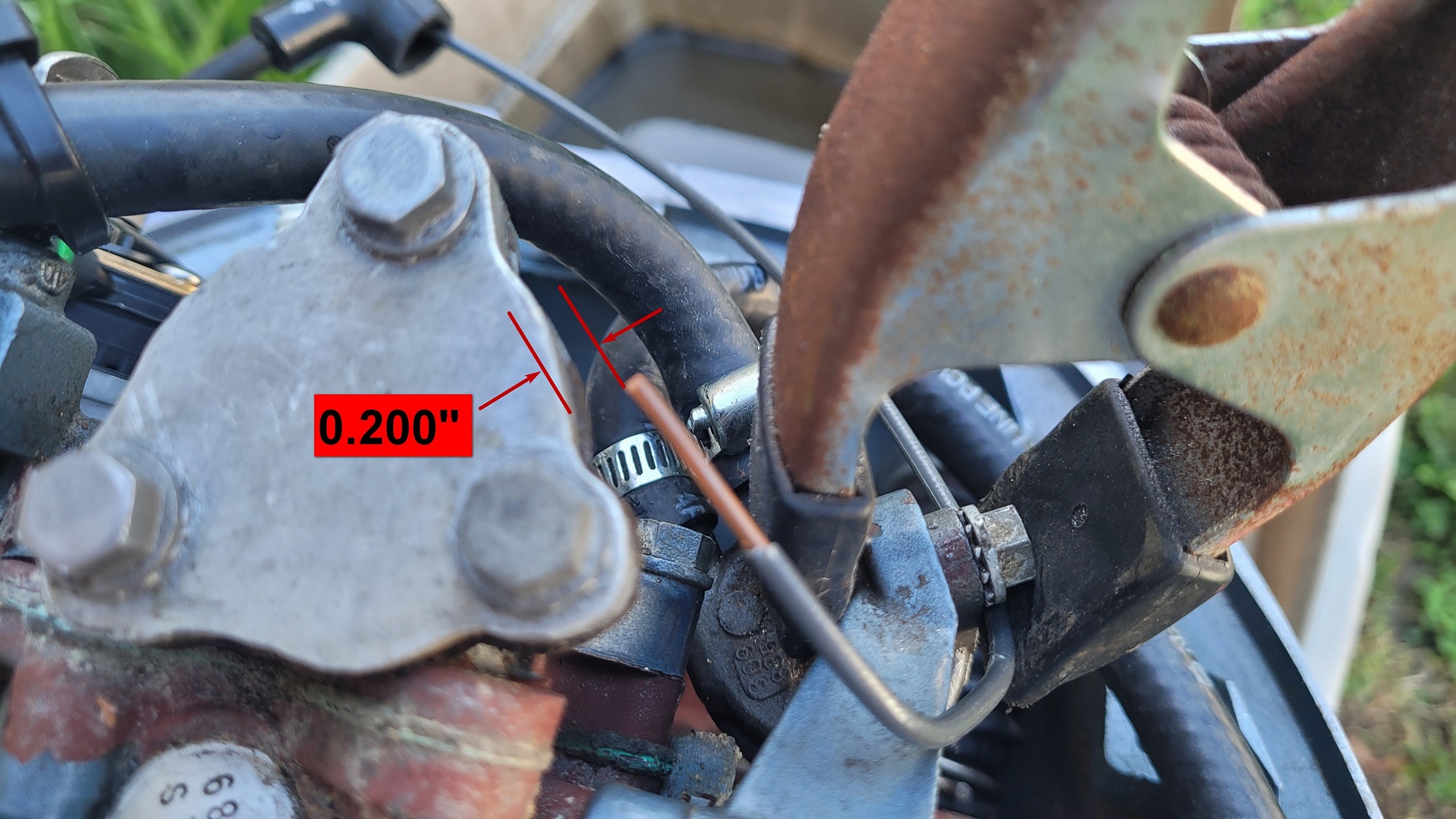

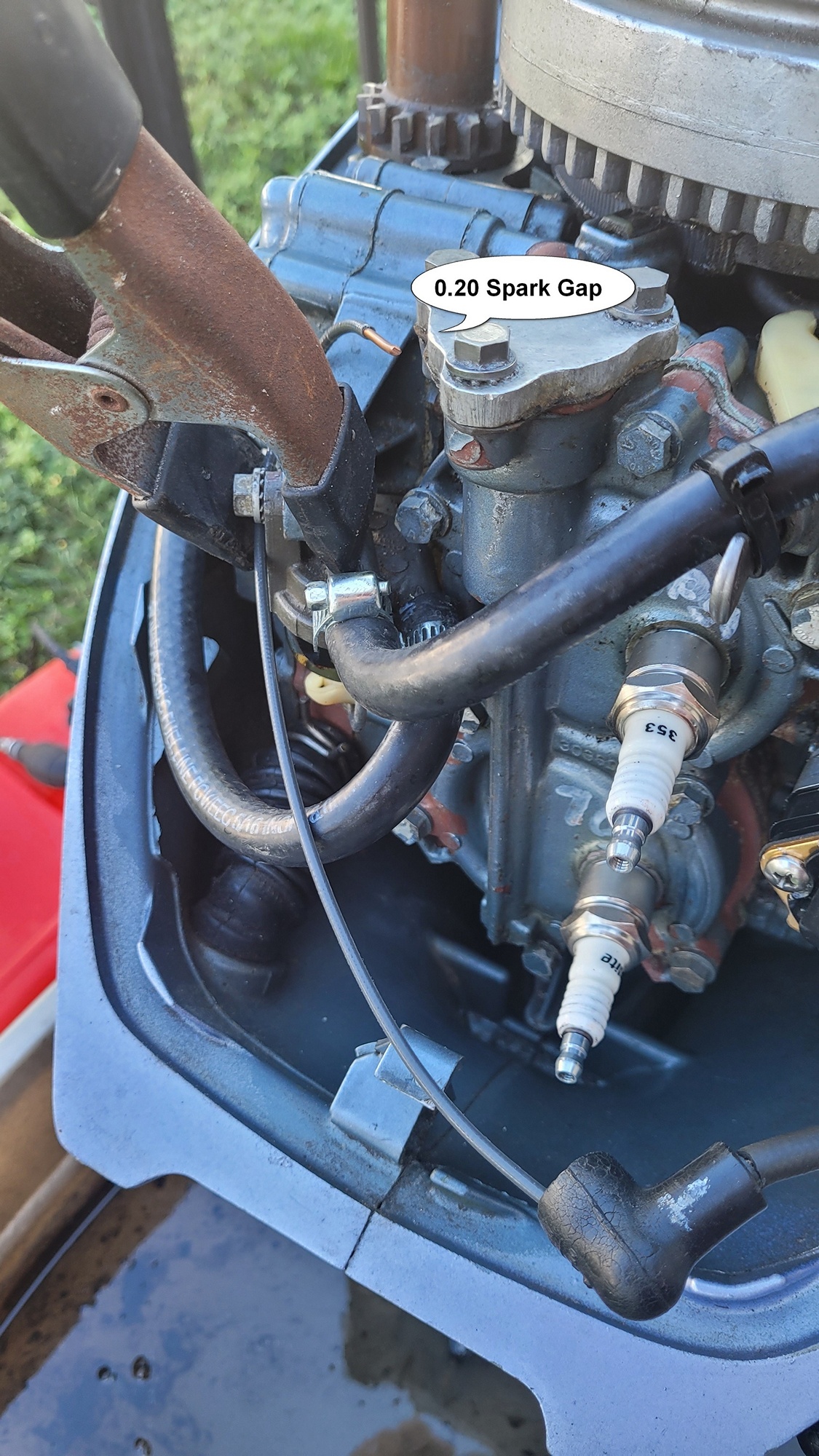

Does spark jump a gap of 1/4 " or more , yes or no ?-----Perhaps motor is only running on one cylinder.----Note---I have worked of many of these motors and have a bunch for spare parts.
Thanks for the reply!!! The engine appears to be running on both cylinders. It revs quickly and strongly but tomorrow, I will rig something so that I can check each of the spark outputs separately for a 1/4" jump. At this point, I will try anything as I'm out of ideas and I defer to those who have experience beyond mine. Happy New Year!!!
Today, I took both wires off of the sparkplugs and I took a length of 12ga Romex wire and stripped both ends. I bent the one end over to make some friction with the sparkplug boots and I clamped the other end of the wire where I could see it with the end about 1/4 inch (maybe just a little less) from an engine component. I pulled over the engine and I could see a spark jump from the end of the wire to the engine. I did it for both cylinders. So the ignition is probably not entering into the equation.

When I had the flywheel off before to check the points and the condition of the coils/wires, I didn't notice any oil or other mess but I suspect that this motor which is 58 years old probably has the original crank seals in it and I will change them both (probably) beginning with the easy one on top. It certainly can't hurt and since I'm out of ideas, I'll just keep following suggestions from folks like you and "timguy" who have been so generous with your knowledge and time. I have virtually no experience working on 2-cycle engines though I have owned several during my time.

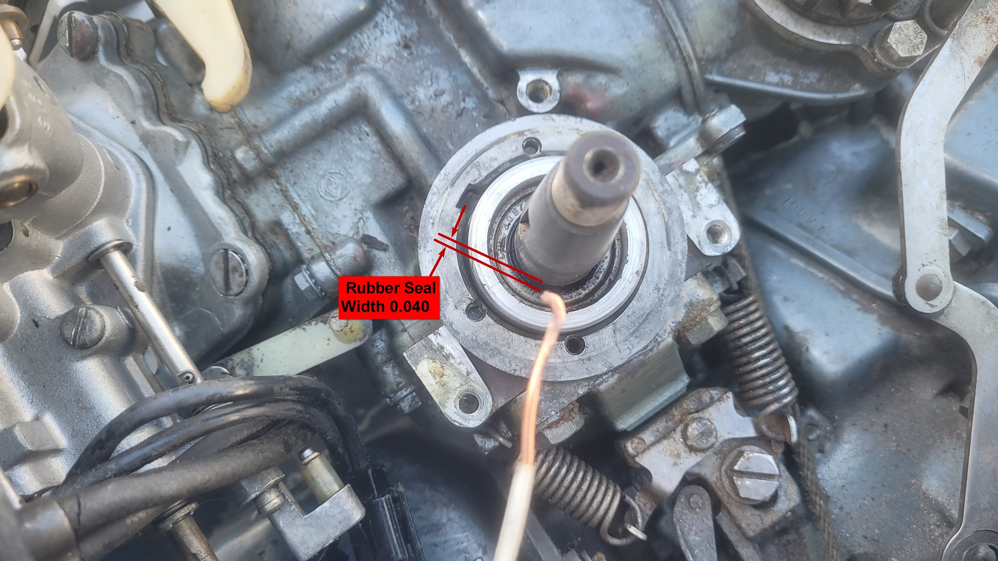

Here's the follow-up to my previous posts. The seals arrived late last week and over the weekend, I attempted to remove and replace the upper seal. The seal for this engine are quite small. The OD is 1.190 and the ID is about 0.760. The metal portion of the seal top surface (on a side) is only about 0.156 wide so putting a hole through it and using screws to engage the hole and pull it is difficult so first I tried making some 12 ga. copper Romex wire(thinking it would not damage the crankshaft, I ground the sides of the wire to make it thin enough to fit between the seal lip and the crank) and bent the tip over tightly and stuck it between the seal and the crankshaft journal then turning it under the seal lip and pulling. Nothing. The wire was not strong enough to resist the pull I made another one and tried the other side. Then I tried both at the same time. Still no movement of the seal and the copper wire hooks bent under the pressure.
If there was no oil all over the points then the seal was still good.-----But now I believe you may have damaged it.-----There is no option but to replace it.-------Perhaps you can find a local friendly shop with the factory puller.-----Seal can be removed in just minutes.-----After all factory tools are the best time savers around.
There were some tell tale signs of a leak. There was a very fine coating of oil on the "ignition plate" and its components but not like it was sprayed all over -- just a coating. Still, I noticed that the seal on this motor had the original part number stamped into it so I assume that it was the original and since the motor is 1964 that means 58 years in service and another forum contributor here was saying the ethanol in "modern" gasoline eats these seals so...........
On Sunday, after watching a couple of pretty good videos (https://www.youtube.com/watch?v=H52J-XPTx24) of guys really familiar with removing these seals and their techniques, I went after it. First I spayed PB Blaster Penetrating oil around the seal. Then, I used a drywall screw and a hammer to punch a hole at the edge of the seal where it meets the engine casting. I then used a 0.125 drill to open the hole with a piece of plastic from a "to go" container jammed between the crank and the drill to prevent a gouge. I screwed the screw in so the tip would meet the bottom of the pocket where the seal was seated and pull the seal upward. No movement. I put another hole and screw 180 degrees opposite. No movement. The pressure from the screws were tearing at the seal and breaking the threads off of the hardened screw!!! I put two more holes so now I had four at 90 degrees apart and screwed down all four screws. I ground the points off the ends of the screws and reinserted so I had fresh threads gripping the seal lip and a flat bottom against the bottom of the pocket. Still no movement. I used a small screw driver and hammer to slip between the OD of the seal and the wall of the engine casting and a pair of long nose pliers that I ground to be much narrower to get into the holes that I had formed with the screws. Ultimately, I was able to remove the seal which represented about three hours of try-and-fail strategy. I CAREFULLY INSPECTED THE CRANKSHAFT JOURNAL WHERE THE SEAL SITS AND THERE WAS NO DAMAGE. I cleaned the pocket with brake cleaner, a rag and compressed air. I used a small ignition file to smooth some of the "jaggies" I made on the top of the block casting where the ignition plate sits. I used a piece of 3/4 PVC pipe that I drilled the center out to fit over the crankshaft (no socket wrench was deep enough to clear the top of the crank), coated the outside of seal with a light layer of grease and tapped in the new seal. I reassembled the engine and started it. The engine will now run without the choke on but it still will not idle low where it's supposed to without stalling. It also "coughs" the "lean cough" occasionally every five seconds or so. It revs easily and goes easily to high speed. So now, I'm thinking that I should try to replace the lower seal. (Dreading it). I have not seen a single video on YouTube (or anywhere else for that matter) of someone doing the powerhead removal to get to the lower seal and the service manual I have is pretty weak in terms of instruction on doing this. Before I'm done, I will likely have a brand new 1964 motor.
Glad you were able to get the seal out. I fought a bit with too small/wrong screws, just split the case as it added only half hour to the repair. Cleaned up the crank with some steel wool, cleaned up the cases, light layer of Gray Honda-bond sealer, two new seals and was back in business. Super smooth idle, no more cough at idle. Previous to this repair I did the full carb repair. Had to bend the float more than OEM spec as it would not fill the bowl enough. Also found the original fuel pump check valves were plastic and were worn. Dug though my bucket of parts and found a pump with metal check valves that sealed correctly. Also bought a small rubber bellow from a Mercruser shift link, cut it down a bit and repaired the 9.5 shift below down in the bottom end. New prop and my dad has a great fishing motor. Let up know how yours goes.
Good job. Did the seal rubber seem kinda "punky"? Did it leave rubber residue on your fingers? From your nice clear photos, it looks to me as it was a "gonner". Racer has stated that they will leak for awhile before they are total failure....allowing unmetered outside air to enter the top cylinder. So if you saw noticeable improvement on your job here, you can expect the lower seal is nasty, as well. Keep in mind, the lower seal is a "cakewalk" compared to the upper. Just gotta figure your steps in order when dismantling the housing, and removing the powerhead, then exact reversal when assembling.
That seal didn't look that bad, bit if it helped to run the motor with no choke on...., for the first time ever,....then I would suspect we are on the right track. The lower seal must be pretty bad. Once again....hats off to Racer. You 'da man. The lower seal inspection requires at least a lower unit removal and a very good light, not to mention sharp eyes. Otherwise you will note an exceptional amount of oil at top of driveshaft.
