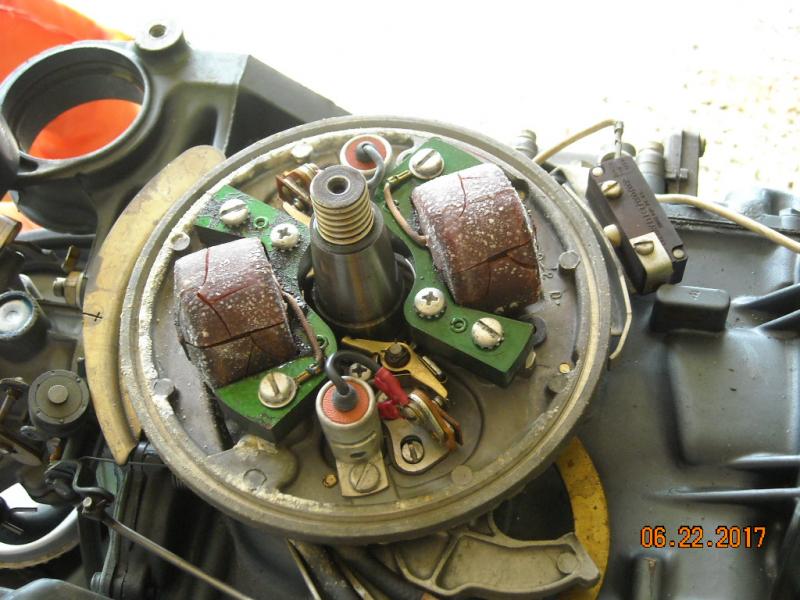

They are scrap !!-----Cheap to replace them.-----Every one of those magnetos from 1960 and 1970's has had them replaced or needs a new set now.
You mean like these?

Exactly but engine still runs good
Then you are experiencing a genuine miracle.... However, trouble is lurking around the corner. Replace them!

Will replace don't want any problem on the lake that can be stopped from happening by replacing. Is there any reason for timing to b off on old motors
When you get the motor running use a timing light.---Magneto always fires with mark on the flywheel between the vertical lines on the magneto plate.----And since the ignition is dual / seperate systems you need to check both leads.

What causes the coils to get cracked and white stuff on them. Does it mean the engine was used a lot or can they get like that just from sitting for years
They just get old like a lot of crackpot people who's hair turns white, retire and quit working....... :cool:
Repeated heat and cool cycles over the years causes the plastic to shrink and become brittle with time. It's the same reason you see older cars with cracks and splits in the plastic on the dash. The plasticizer compounds degrade and changes the pliability of the material until it finally breaks.

When a coil is wound the copper wires are separated buy greased paper and when fully wound more paper is unsed with usually a plastic coat to protect the windings. The coil can be still operational if this plastic cracks and if it is then I would suggest just re-covering it with a rubber sealent to keep out moisture.
When they are cracked it is just a matter of time before failure.-----They are cheap and less trouble to replace than to patch for more life from them !!!

What would a person do put a thin coating of gasket sealant all over the whole thing or just cover the cracks
I'm with Racer, I'd replace them. But, if you want to give it a whirl I'd use some form of high temp epoxy, JB Weld, or similar material. Elastic materials like Plasti-Dip and coatings like that may not fair well. Personally I would coat the whole thing to allow the material to bond all of the parts of the old plastic together.
