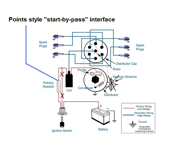

This image shows an automotive points style system.
Your Marine application will be minus the vacuum diaphram advance, and will be minus the start-by-pass that initiates from the key switch.
Your start-by-pass will initiate from the starter motor solenoid I or R terminal.
As far as the contact points and coil are concerned, you can use this schematic.

Here is a 4 cylinder point igniton schematic. The wiring should be the same with the exception of 2 V6 or 4 V8 more spark plug wires...........
