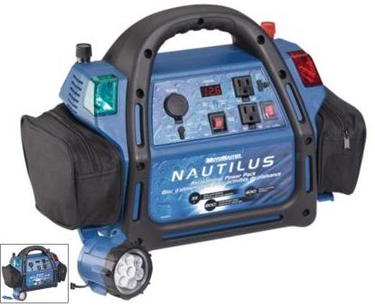

I prefer one battery + 1 of these on board.
