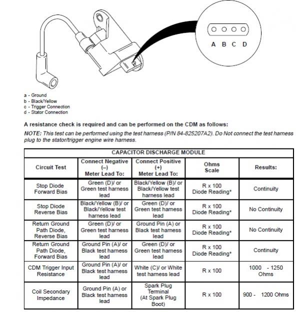

I know there are a million posts and videos out there about testing coils, so I'll go ahead and say it now maybe I'm an idiot but they all seem like they are speaking Spanish to me. Mine is on a 2000 125hp elpto. Part number of the coil is 827509-A8. It has a plug with 4 prongs and of course the spark plug wire. Where do I put the negative and positive posts of the multimeter/ohm??
You have a CDM ignition system.
Here is the way they are tested.

You are testing the integrity of the coil itself between it's (pins), not between the coil and the engine ground, trigger feed etc etc.
Should work either way is my thought...
The ohm readings check out good, but when I switched the meter to the continuity test it never beeps where it should have continuity. And this is while the coil are removed.
