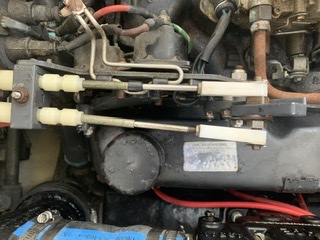

I’m prepping to put in a new drive. With all the finicky parts needing to work perfectly together, I noticed my cables for the two remote stations are not exactly parallel at the engine bracket. Anyone think this is an issue? No binding, they both are smooth and light effort. I could swap the bolt and make them exactly line up parallel if needed. The boat is new to me and the outdrive was not working when I got it. So I don’t know if the cables had caused any previous issues.
