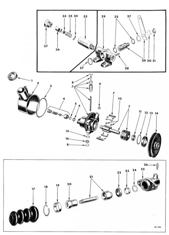

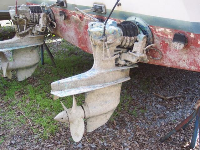

Will get pics as soon as I can get there. The shifter performs two functions like you said first clutch then gear selection. It's an odd cod. 1969 Nautiline houseboat. Just bought a flybridge and am trying to get it lined up before I install it.
Not my drives but twins to them.
Your drives are 45 years old.

Dana drives are just too stout to want to replace. I already have 2 spares I will most likley never need. As long as you keep the adjustments right a big block won't kill them. If I were to reporwer I would go bravo3
Well, I only mentioned the AQ series because:
  • your Dana drives are now 45 years old.
  • Dana parts and service may now be somewhat scarce (I don't know).
  • apparently the Dana is not oposite of engine rotation capable (picture shows LH props Stdb and Port).
  • steering system looks rather antiquated to me.
  • no power trim ability... yes/no?
