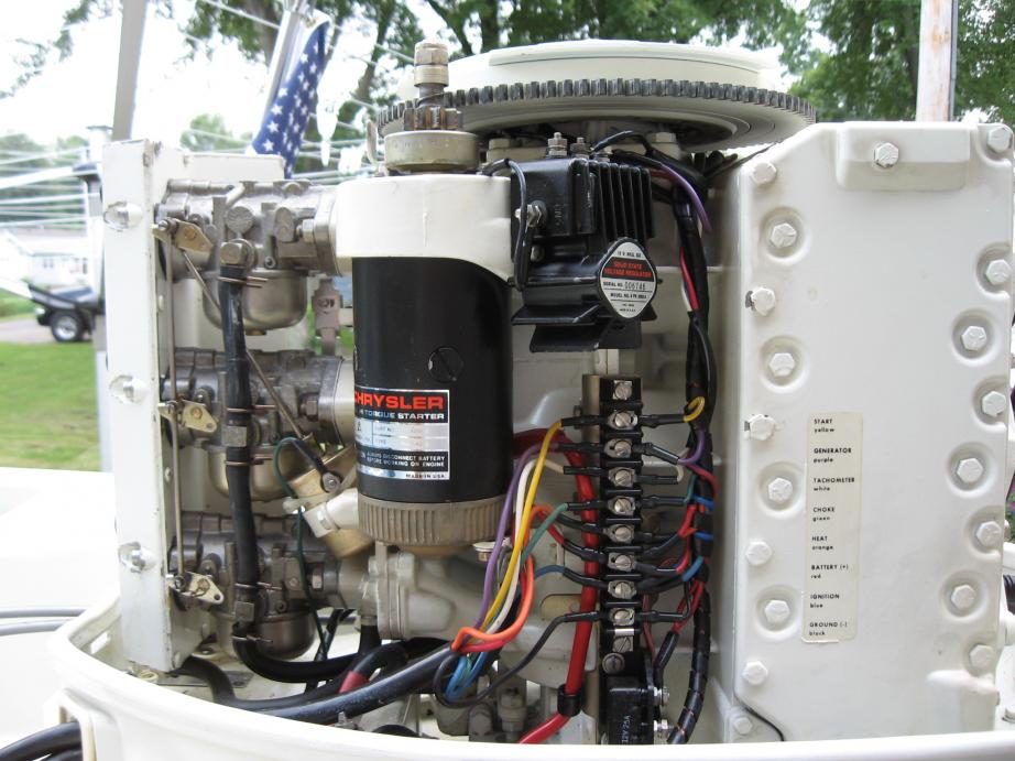

Just want to say thanks, wayne55 & Jerryjerry05, for your info in this forum. Last year I purchased a 1976 Thunder-craft & 75hp Chrysler outboard. Both are in mint condition. Yesterday, I blew out the CD pack, called the local Merc. dealer to have him tell me the replacement was no longer offered. Wayne55, I saw your pics & noticed your cd pack was already replaced on your outboard. I got the name & part no. from your picture, went to the CDI website & there it was. Monday I will order one from MarineEngine.com.
As far as fuel economy goes, per my GPS, I went 26 miles on one tank (6 gal.s) of gas. Being very "throttle sensitive" that's not to shabby.
Again thanks, & here are a few pics of my unit before the box went out.
