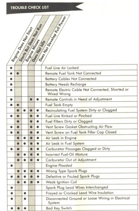

Here's an outboard checklist........................
