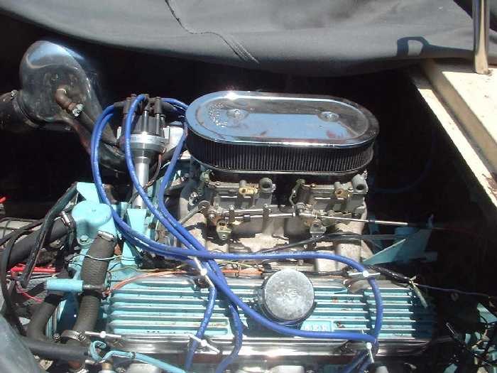

The 440-375 used the same cam as the 426-350.

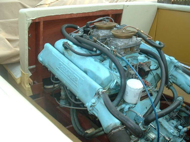

True. There are a few mods needed to convert the Automotive 2 v carbs for marine use. I know dual 4v's is easier as there are marine 4v's available.
The manifold is a Edelbrock CH-28. It's in a 73 Century Arabian and sits level since it's a V-drive. (Paragon PV-400). The 426-350 straight inboard uses cast iron wedges to level the 500CFM AFB's The 426 is in a 1963 Century Coronado.

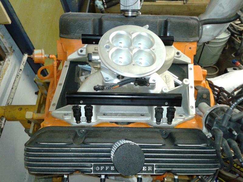

I've left the dual quads in favor of MPI.

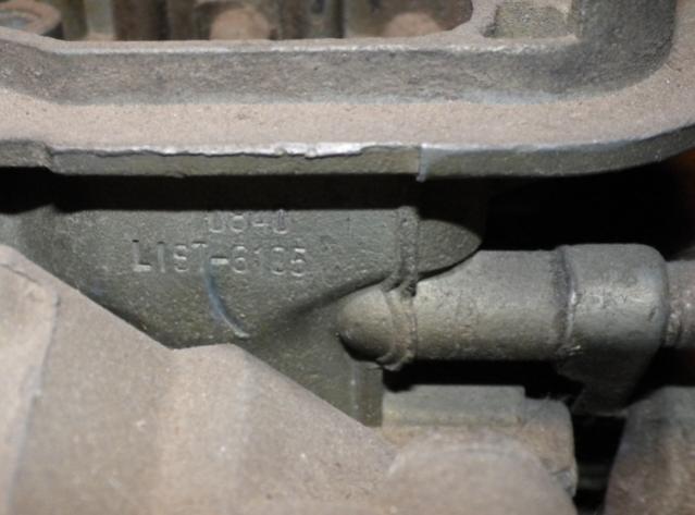

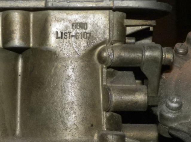

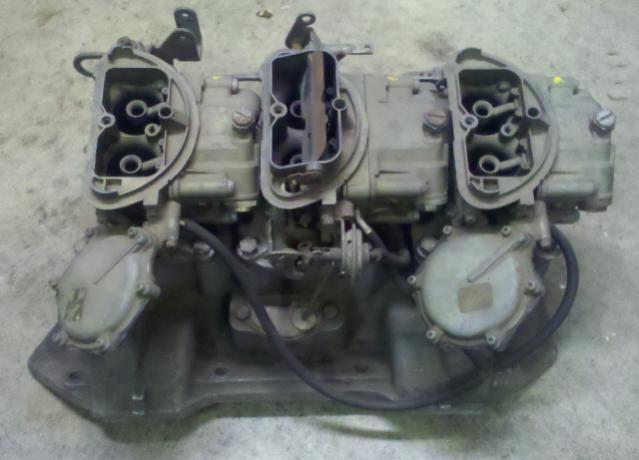

I think the tri-power is just as neat as dual quads.
6packMarines.jpg Maybe even more unique if you actually could find a set that hadn't been modified..........
6packMarines1.jpg About 250 cfm from the center when your putting around and 1000 cfm when you need to get the ya-yas out.

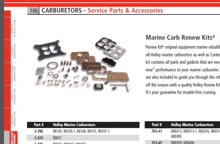

Sorry Jeff, you are wrong. These are the marine carbs! Go look in your Holley list numbers.
Tony, not really looking to off load at this time. I want to get them cleaned up and back to spec (bowl vent j-tubes and rebuilds) but I'm in no hurry. They are out there though and more likely they have found their way to the "dark" (automotive) side. If you hit the swaps or advertise for specific list numbers like at Dodge Forum, A-bodies Only Forum, Bigblock Dart, etc. you may score a lead on a set.
Sorry, but I found only marine FOUR barrel carb stuff there. That said, Holley must have made a 500 two barrel marine carb for SOMEBODY, and I assume that's what the SIx Pack carbs are.
Jeff
The Six Pack carbs are 3 Holley model 2300's. They were rated at 350CFM for the center and 500CFM for the front and rear. The center carb was the main carb, used for start-up and idle and the front and rear were connected via a progressive linkage with vacuum operated throttle blades. It was like having two sets of secondaries acting as a single six barrel carb. It was quite ingenious at the time.

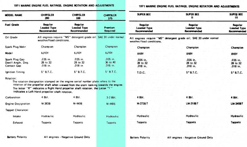

Some specs for M440S.........
