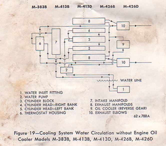

The original manual for the 8 cylinder Chrysler Marine engines lists diagrams for water flow for all engnes but the 426. Is the water flow for 426 same as M413 or M383?
Or better yet, if you have a properly running raw water cooled 426 with a dual pocket water pump, please reply with how your water flows around the engine right now.
Thanks,
Akin
